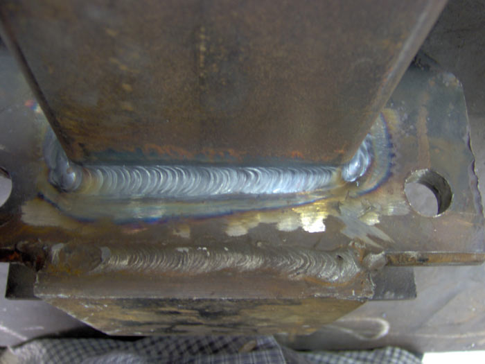

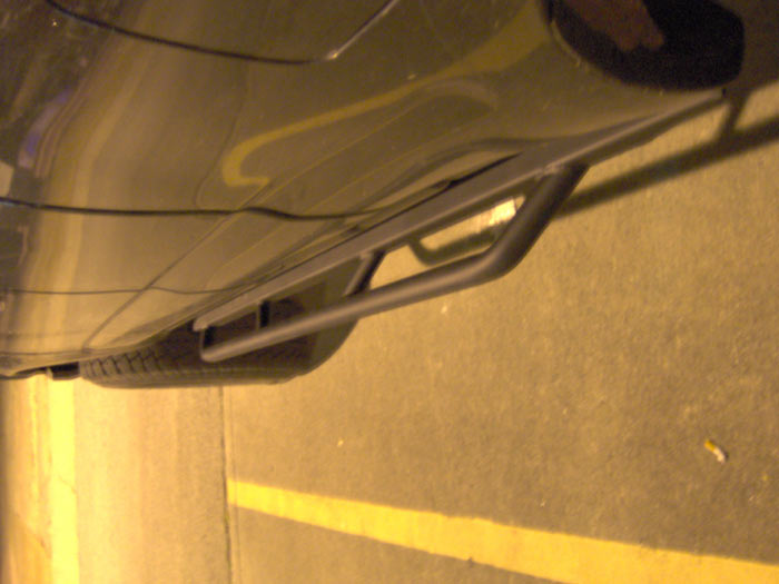

speaking of sliders i just got these done, the joints are all heliarc'd
Attached Thumbnails Any TIG welders in the group?-1.jpg   Any TIG welders in the group?-2.jpg   Any TIG welders in the group?-3.jpg

Sweet sliders! I've got to get busy and make some for myself.

nice

Fellow Pipe fitter/ Welder here, Nice tig rig, would love to see some specs on those sliders. I have a t-100.
