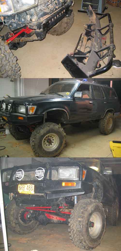

SAS with ARB

That looks really good Matt. It looks like you got the rear raised a little more since last we saw it, what did you end up doing? I have got to get some of this AP stuff coming in and start lining up some welding time, Matt are you handy enough and confident enough in your welding to weld for me?
Good luck with the ARB Jermey, hope that guy in Washington state comes through for ya, ARB capital should know better than anyone.
