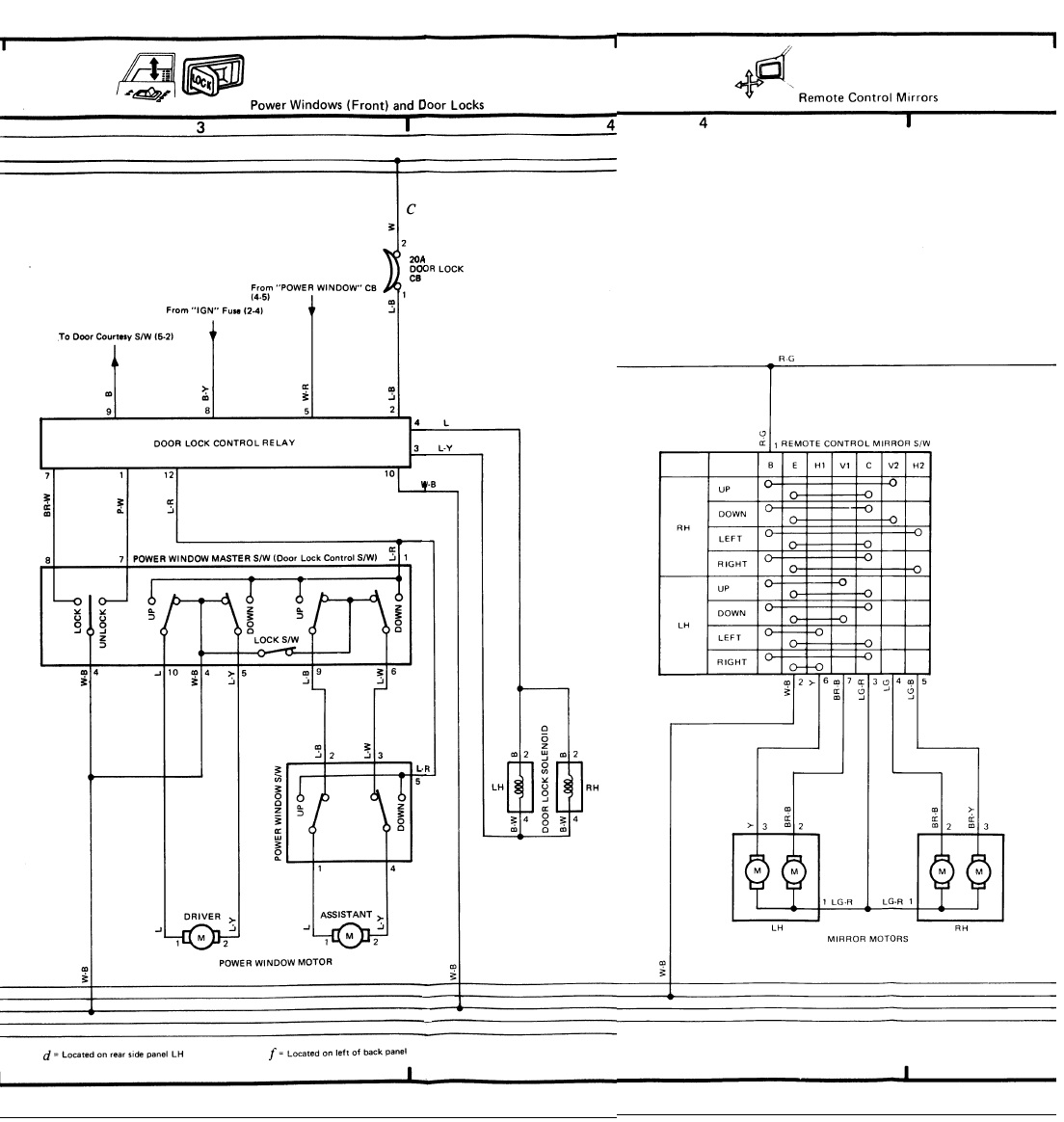

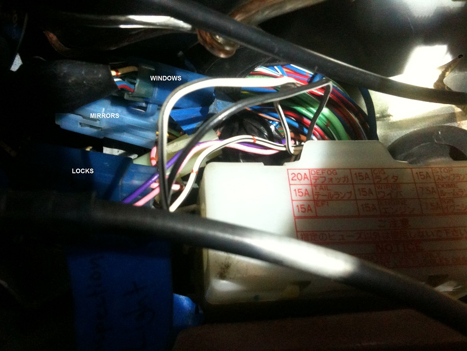

The answer to your question on the wiring is:
If your truck has the SR5 package then YES you are pre-wired. If your truck is the base model then no you are not pre-wired. To find out for sure look under the dash above the fuse panel. If you are pre-wired there will be three blue wire connectors 1st for the door locks 2nd for the power windows and 3rd for the remote mirrors. Good luck.
