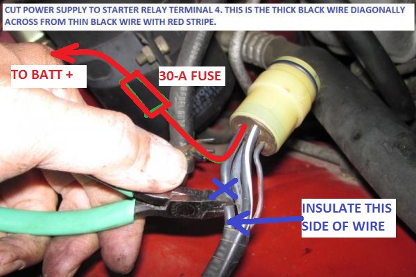

If you have a 22R-E 5-speed, we already know of the cranking system design/wiring flaw (here). You can easily/quickly fix that before the cranking issue happens. Fix is here:
Connector shown is for starter relay inside right fender near windshield wiper motor.
Fuse should be wired as close to battery as possible. Details are on my signature.
