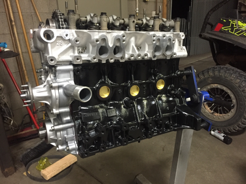

Motor is coming together nicely
Attached Thumbnails Dharris1986's 1988 RWD pickup build/restore-image-2617159700.jpg

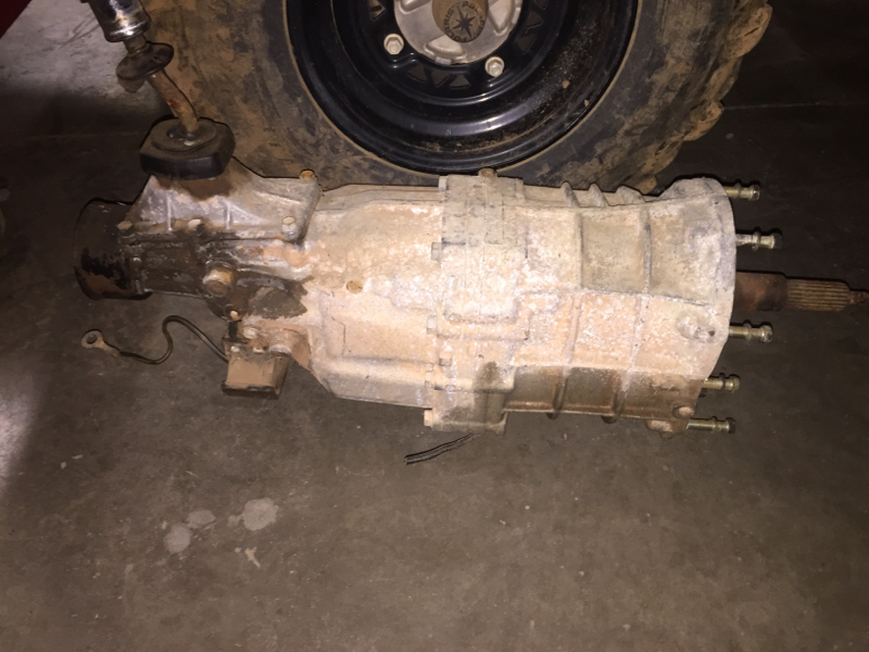

A friend gave me this tonight, I think it's a w55. That'll be a nice addition.
Attached Thumbnails Dharris1986's 1988 RWD pickup build/restore-image-2604029068.jpg

I dont know the transmisions as well but I had a two wheel drive with a 4 speed and I put a 5 speed out of a Celica and it bolted right up. Best upgrade I ever did to that truck. Motor looks great.

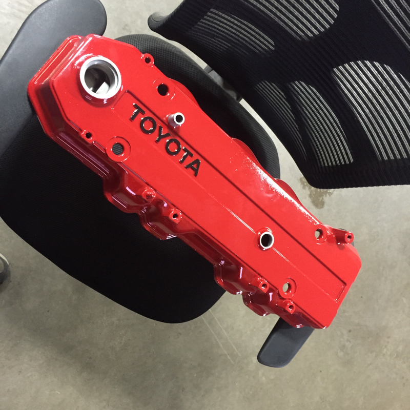

I got my valve cover cleaned up and painted last night. Getting closer! GM one wire alternator mount should be in Tuesday and motor should be sealed up by than.
Attached Thumbnails Dharris1986's 1988 RWD pickup build/restore-image-2389391807.jpg

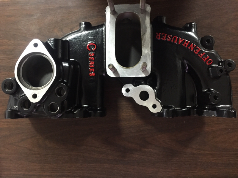

Painted and detailed the intake manifold yesterday and today.
Attached Thumbnails Dharris1986's 1988 RWD pickup build/restore-image-692275520.jpg

It turned out to be a w55 transmission which is exactly what I was wanting to find. I'll get it completely sealed up and painted and ready this week. And thanks for the compliment on the motor.

The w55 transmission i got has a worn out shifter as does the original transmission in the truck. When you move the stick left to right in neutral the washer under the retainer plate pops out a little and hangs up. I can't find a used one anywhere i look so i'm going to have to import one from Australia. I found a company called Cube Speed that makes a complete short throw replacement for a supra that will work with my W55. It's going to cost me around $155 plus any duties uncle sam may want. It has a removable stick, so I'm planning on adapting my stock shifter to the short throw assembly, in the correct position so it will look basically stock, but shift much nicer, in theory anyways.
