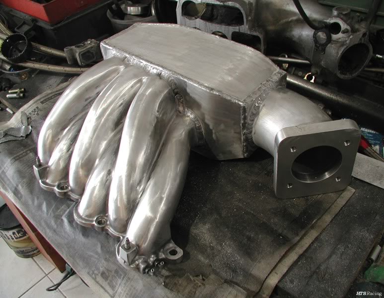

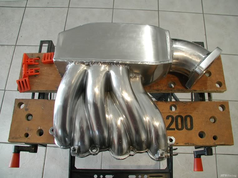

Originally Posted by Toysrme
AL-LA turn this part:
Attachment 172499
Into this:
Attachment 172500
Attachment 172501
1) The air chamber should extend PAST the runners (Even on your style, this will improve charge flow to both the end runners which will always starve when places close to a wall.)
2) The throttle body pipe should be angled into the plenum to some degree.
