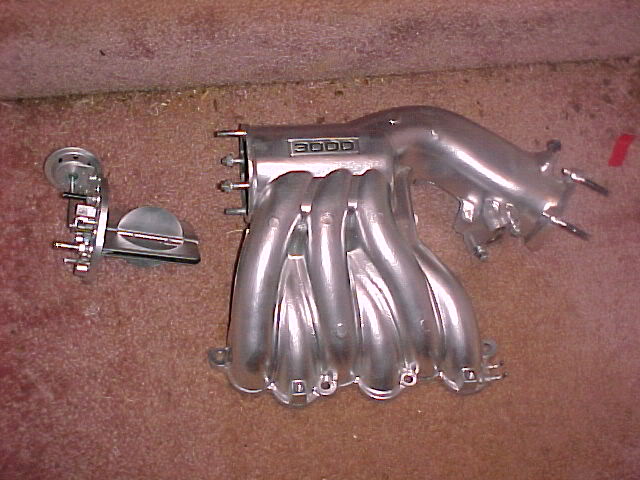

Agree to a point. The plenum and intake have very small ports - they are restrictive compared to later model engines. Just the nature of the beast. Same is true of the valve sizes.
I don't blame the AFM; it's not hard to build a 22re to produce a solid 140-145HP using the stock AFM (20% increase in HP), and dyno numbers (again, see scott and DOA) show that there are gains to be had w/o touching the AFM.
Remember HP is dictated by flow volume and flow velocity.
I agree though - start at the vafm. I personally did the math. If you combine the total cross sectional area of the 6 runners they have about 35% more cross sectional area than the intake plenum's opening (of course there is about 8x the amount of surface area that the air charge is interacting with....) The Intake plenum's opening is about 3mm larger than the TB, and the TB is around 5.8sq in, the VAFM plate is only 2.25sq in at WOT. Mathematically your largest gains short of cams will be the VAFM followed by either the TB or the runners.
Anyway, I for one am very happy to see SOMEONE investing R&D into the 3.0. There are plenty of them out there and even a few of us who really like the darned thing.

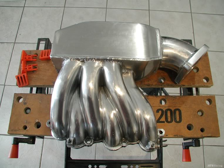

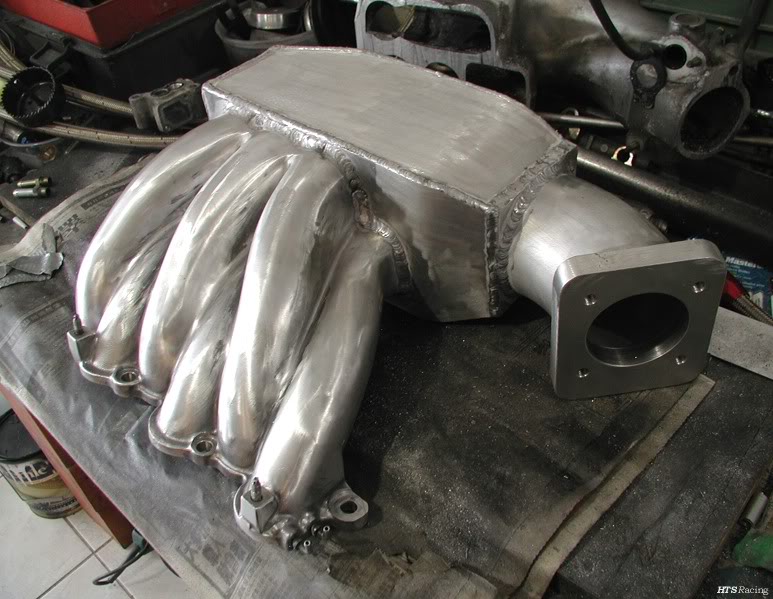

The plenum runners are the right size and shape. They provide more flow than the engine is capable of injesting - even modified... Without sacrificing charge velicoty. The problem is that the plenum chamber itself is too small for good high rpm use, or lots of boost to build up for anyone that later goes FI.
Most Japanese Intake Manifolds have the exact same problem.
You want to make the intake manifold lots better - cut the entire Air chamber off, and design your own. For example from your 3.0L car buddy (That's me).
AL-LA turn this part:
Into this:
1) The air chamber should extend PAST the runners (Even on your style, this will improve charge flow to both the end runners which will always starve when places close to a wall.)
2) The throttle body pipe should be angled into the plenum to some degree.

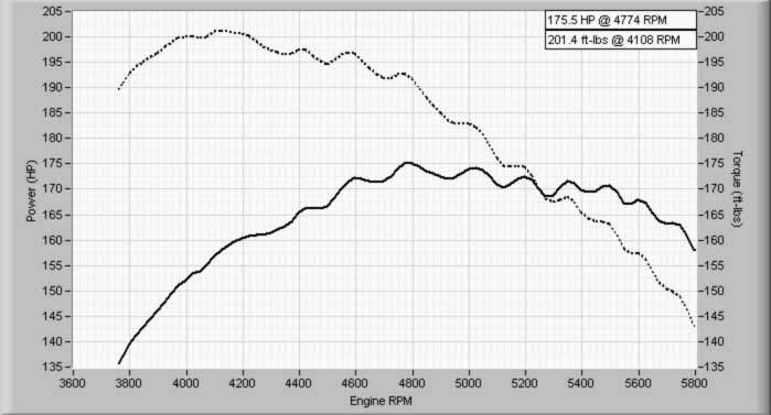

I don't think you've run dyno numbers, m'friend. It's not hard to make a 3.0 product 180+HP. Not overly cheap, but not hard either. Tim @DOA has a 200HP version and I believe a 210HP version; that's 35% more HP than factory. There is plenty of room to work w/ the 3.0. Again, I'd like to hear *YOUR* answers to making hp from the 3.0 - especailly before bashing someone elses attempts to help out the 3.0 crowd.
HUH? Some N/A Toy V6's are pushing well over 250 HP. There's plenty of room to work w/ the 3.0 in that area. Again - I ask you to share your power making ideas.

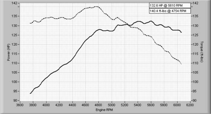

Last dyno I saw (and it was on yotatech) headers + CAI on a 3vz-e gave 10whp over stock... Granted, intakes don't do anything much one way, or another on N/A stock Toyota v6's. So I'll give a full 10whp for headers. 1mz-fe's make 10whp off their now unavailable Bosal headers. Yall have got the wrong impression if you're treating a 12 hourspower gain as something to write home about. I always feel bad for you guys with the 3vz-e, that's why I try to help out if I can, but if a 12 horsepower gain is the best you can do, you've got as much pity as I can possibly give.
Most Honda manifolds dyno 10-12whp.
The simple fact, proven by the 1mz-fe + TRD charger, and a few 1mz-fe's + Bosal headers, is that the 3.0L manifolds are not sent by the devil. You 3vz-e's have a hard time with the crossover pipe, but it's not "ruining all the fun".
Into this:
