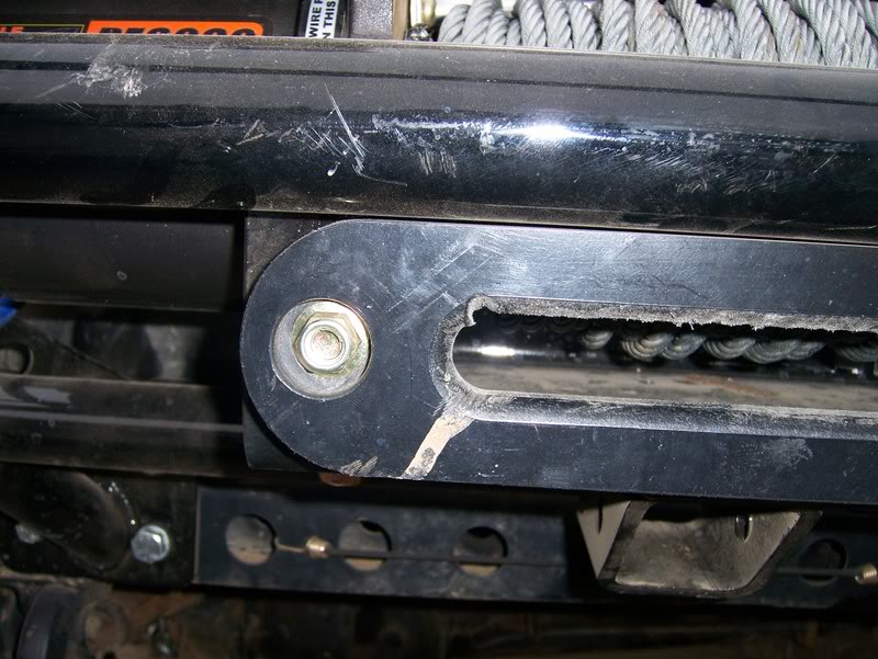

You can also use an UHMW polyethelene fairlead w/ steel cable.
Old Apr 29, 2008 | 11:20 AM
dirtoyboy's Avatar
Joined: May 2006
Posts: 2,377
From: St. Loser, Misery
Like this one?
Old May 3, 2008 | 08:50 AM
texcat101's Avatar
Joined: Mar 2008
Posts: 417
From: W. Texas
That looks like a good reason to go with the steel one.
