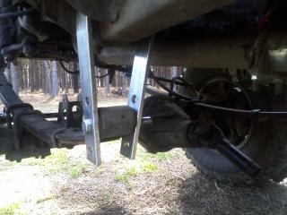

the shackles i put on there acheived the lift i was lookin for, now its just the draveshaft and the 3rd member rotatin upward. did you look at the pics? and yeah i dont give a squat about flex, all i care about is the biggest tires i can fit and turn lol

these are pics of the shackles

yeah i saw the pictures.
here's what i made to put a damper on the axle wrap
if you look at the leafs when your braking they separate in the front. just bind them together somehow and it will give you a much more solid feeling

I went and looked and my leaves ain't seperatin, they are just flexin under the truck. it seems like the whole axle is twistin up under the truck. I put the driveshaft back together and it stayed while i was in 2wd but when i locked it in 4wd it damn near knocked a hole in my tranny pan lol.

yeah its axle wrap

A couple of options for front axle wrap. One is to rig up a traction bar, the stock '85 and earlier trucks had a torque rod from the factory that helped control axle wrap. But if you have crossover steering, you can't use that setup since the rod runs up through where the steering linkage goes. So a rear mounted traction bar would be required. Usually need two mounting points on the axle and a slip joint or shackle on the rear end to handle the shackle motion. Or it is pretty easy to make a set of anti-wrap leaves like I did:
- http://www.4crawler.com/4x4/4R_suspe...l#Update-part2
Basically a half a spring leaf that sits on top of the pack with a clamp that runs down underneath the main leaf. It's purpose is to pull up on the spring pack to resist the downward twist the axle puts on the rest of the springs. I find it works quite well, at least at slower speeds.
