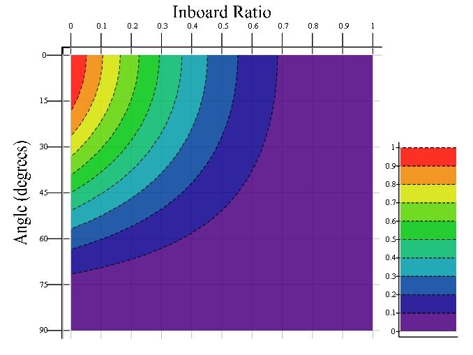

Well, two conditions to look at with inboarding the shocks, with them mounted vertically. For straight up and down suspension movement (equal on both sides), it makes no difference where the shock is mounted as the whole chassis moves up and down equally relative to the axle.
Only for cases where you have body roll or axle articulation will there be a difference. And then, you'll see two factors at work, both related to the inboarded shocks. Firstly, their leverage on the axle, relative to the wheels will be reduced by their degree of inboarding. But then, just like the angled shock case, the shock will compress slower the more inboard it is mounted, and thus will generate less force.
So you again get into a case where you have less force acting with less leverage so those two effects must be combined, at least for the body roll case. So for a shock mounted 1/2 way between the WMS and center, it has 50% leverage against rolling and will make 50% the force since it compresses only 50% as fast as if it were out farther, so it is 25% as effective as the same shock out at the WMS (which of course is not practical to do).
The "real" effectiveness would lie someplace between the up-down value and the roll value, depending on what mix of suspension travel you wished to test the system with.
Oops, missed that. Good catch.
EDIT:
And just for good measure, a graph comparing the qualitative behaviors of angled and inboard shocks. I made the X-axis a ratio, where for the angled shocks the angle is 90deg*Ratio, and for the inboard shocks a distance ratio measured from the WMS divided by the distance from WMS to the center of the axle. Obviously, there is no cross-over optimization in this case...
EDIT AGAIN:
Or if you prefer, a pretty picture comparing the two. "Overall Effectiveness" is defined as (Angled Effectiveness) * (Inboard Effectiveness). Also added a contour plot which is possibly useful for seeing where your shocks sit in terms of overall effectiveness.

For a given length shock, the more angle the shock is off of vertical, the more travel it will have in a vertical direction. So at 45 degrees, the shock is only extending about 70% of the amount the axle moves. Now whether that equates to more flex depends on what is limiting the flex now. If you were shock-limited before, possibly because of the shock mounts, then yes, angling those same shocks inward would give more flex, assuming the springs will accommodate that added travel:

No real ultimate placement rule. More vertical makes a more effective shock, angled over more gives more travel from a given length shock. So it all depends on what your goals are and what shocks, mounts and suspension setup you have. If you have a truggy and can mount the shocks anyplace you want (and as high as you want), then you can put in a long enough shock to work fully vertical. But if you are stuck with shocks mounted below the body/bed, then it is unlikely you can fit a long enough shock underneath there straight up and down. So angle inward until you can. That is why I made my upper shock mount with 6 mounting points/side:
