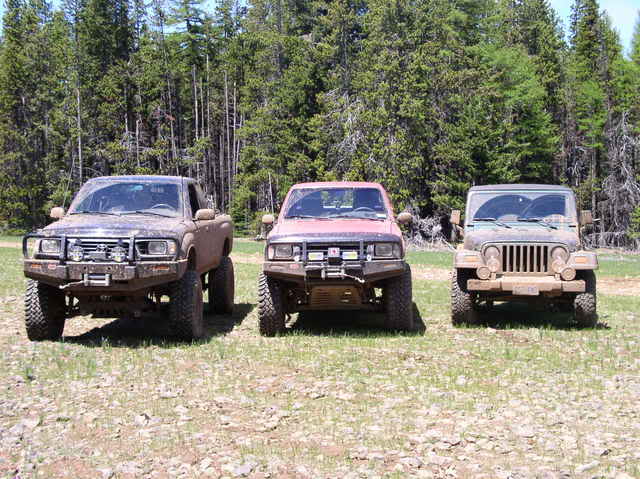

I reccommend 15x8 and 3.75" BS, that is the optimal backspacing for fittment.. you stance will be about like this.... as these are 353x12.50 on 15x8 and 3.75" BS and a 4" lift...
the middle truck
that tacoma is for sale ... here
