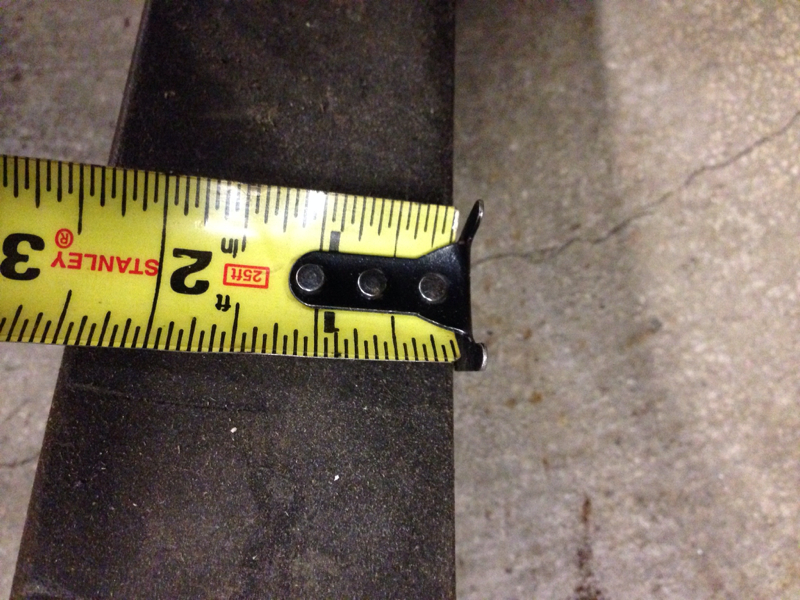

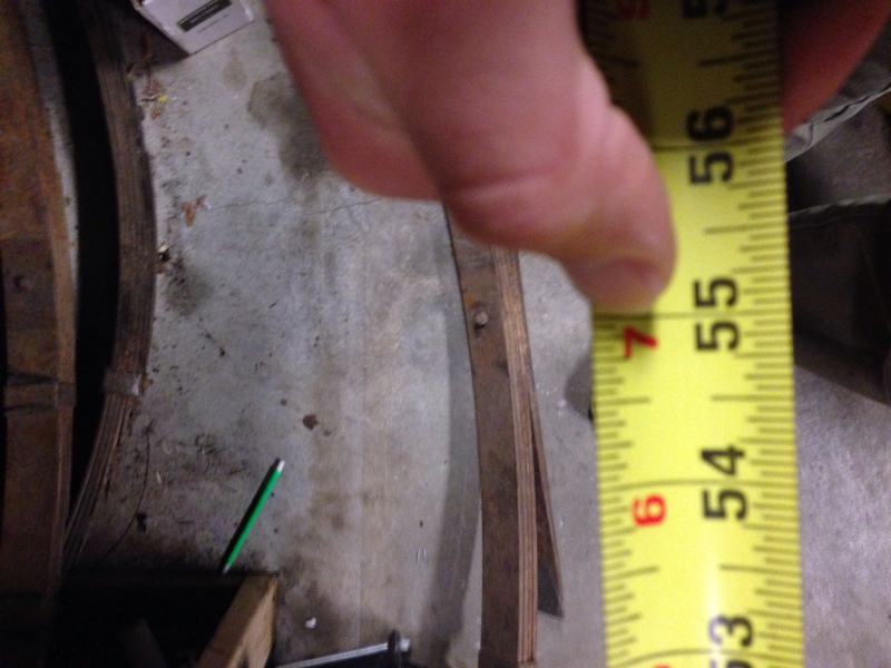

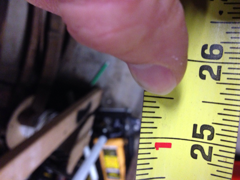

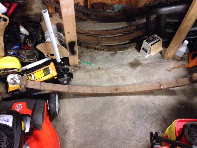

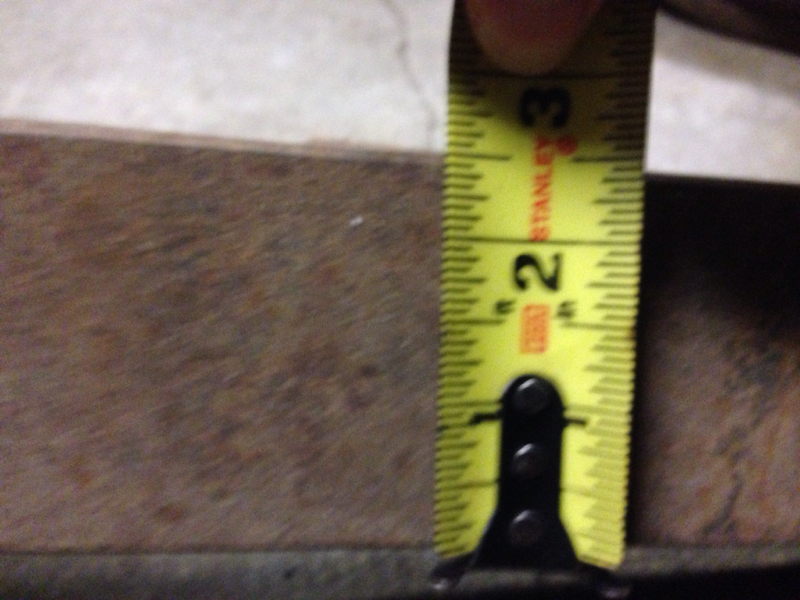

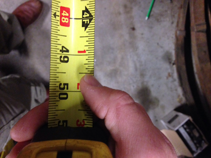

What springs are those? I went and took a peek in my shop and looked at the ford springs that i've got and they look like they are 55" long eye to eye and 2.5" wide and are only a 5 leaf pack. I will take more distinct measurements and take photos of them when I have a chance. It will probably be this weekend though.

Some pics Ford leafs first Leaf pack building and need-to-knows (for me)-image-1295469059.jpg Leaf pack building and need-to-knows (for me)-image-4252178768.jpg Leaf pack building and need-to-knows (for me)-image-790601597.jpg overall length of springs Leaf pack building and need-to-knows (for me)-image-1909287672.jpg Wagoneer springs Leaf pack building and need-to-knows (for me)-image-460385214.jpg Leaf pack building and need-to-knows (for me)-image-2954475840.jpg Leaf pack building and need-to-knows (for me)-image-3725691675.jpg Overall length Leaf pack building and need-to-knows (for me)-image-835227722.jpg Length from center bolt to middle eye on end Leaf pack building and need-to-knows (for me)-image-1193809487.jpg Length from center bolt to middle eye on one end Leaf pack building and need-to-knows (for me)-image-1813863277.jpg
