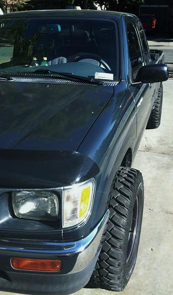

Picture of it right now with fabtech lift spindles and MTs (don't ask me why I did it, it seemed like a good idea at the time)
