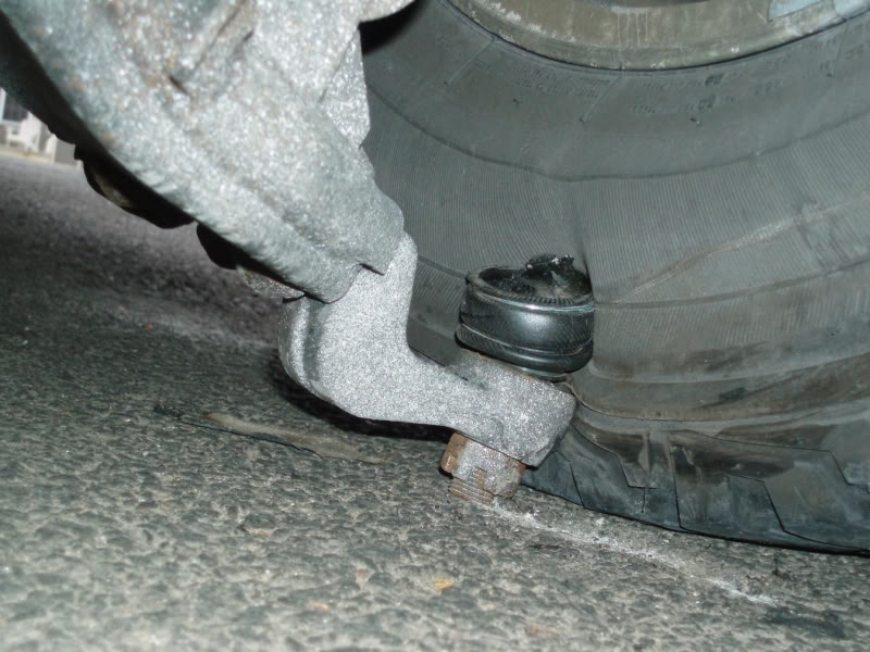

Originally Posted by snobdds
Ok, we get it...you have an axe to grind.
No matter if there was a design flaw or not, the prudent thing to do is check the ball joints on a regular basis to catch these issues before they happen. That goes for any set-up with ball joints.
These models yes check the balljoints!!! Older and newer models can ride around on sloppy worn balljoints ..the wheels still won't fall off!!! And yes I am pissed when I see poor engineering especially on Toyota Trucks and after my buddy was nearly killed in his Tundra..( First post on this thread)

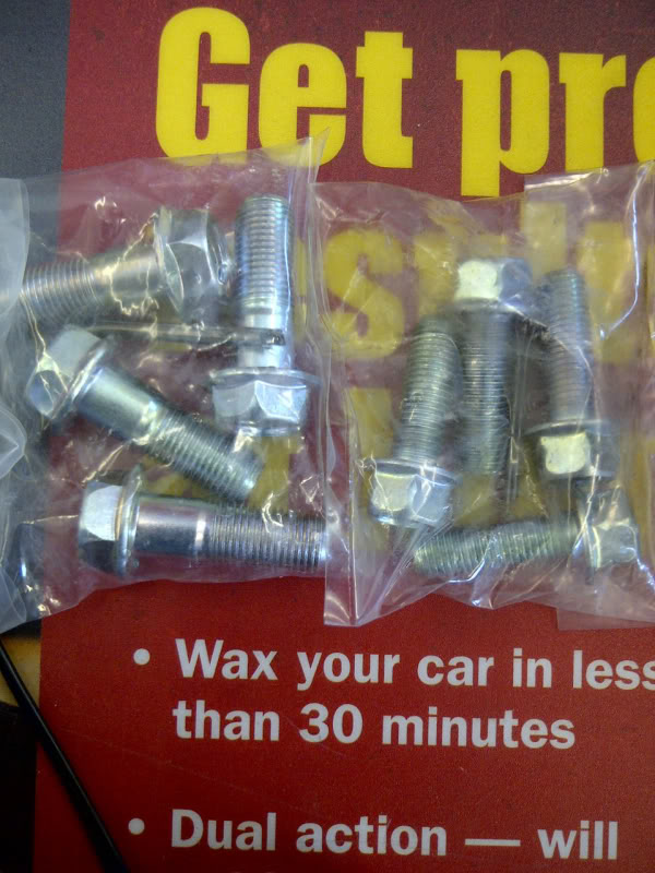

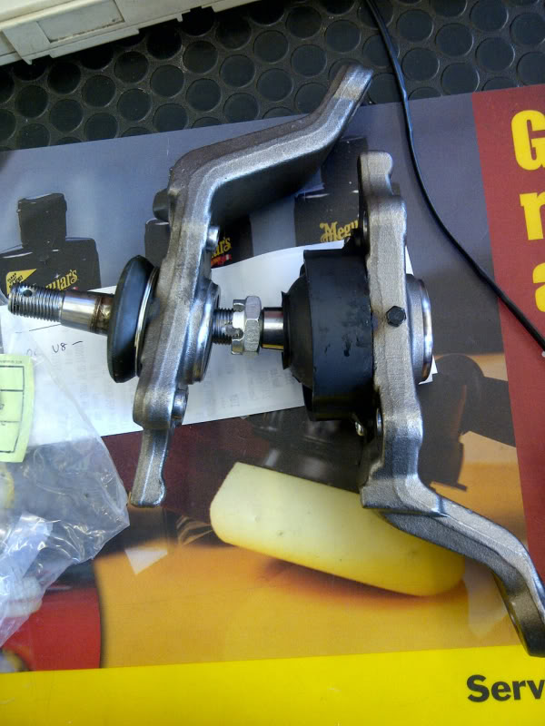

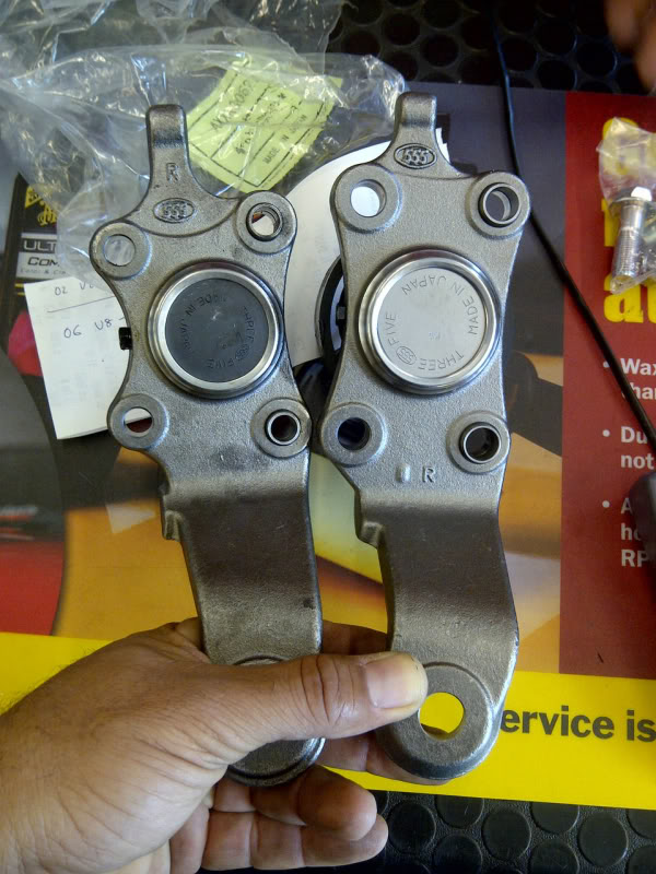

Old Feb 21, 2013 | 12:54 AM
  #57
milowilli's Avatar
Joined: Dec 2006
Posts: 267
From: Naples FL
This is an attempt by Toyota to fix the problem.note the difference in size between the pre 04 model on the left compared to the 04 to 07 model on the right..bigger everything..bolts and balljoint. To convert you will need the newer spindles and Lower Control Arm.
