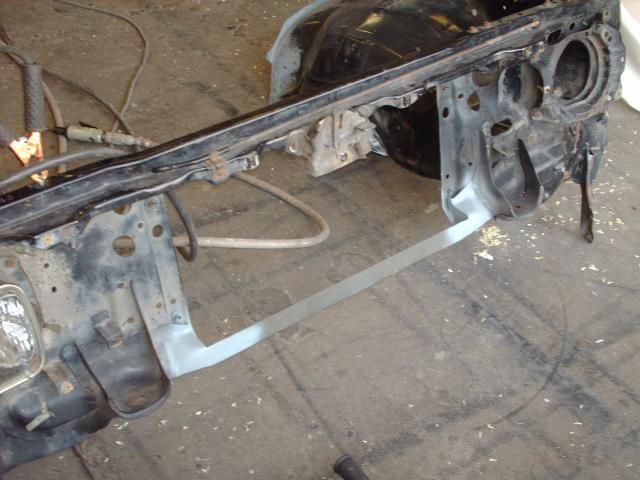

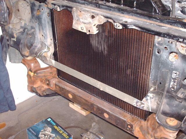

also got the new fan in today , so .. got the front lower rad support cut out , and fan mounted
test fit the grill
and made a NEW lower support ..
I still have to make the center support , and finish welding , but this will hold it together for now .

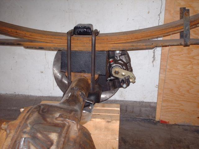

so finally got my rotors back ..
just for referance , rotors are for the /80's chev 6bolt light duty 1" thick .. (the heavy duty 1.3" thick wont work with the calipers ).
center hole has to be "bored" out to fit the toyota axle ..
so with that the new bearings
are "poped" into the bearing retainers
outer seal installed
and then pressed on to the axle .
axles are stuffed in , and rotors are installed .. calipers , and test fit of the pads .
and done ..
and back under the truck .
now to figure the emerg. cables ..

just got the new front pads
and stuffed them into the calipers ..
also , flipped the emerg. leaver over .. to make a straighter line for the cable .. now there wont be any interferance with the u-bolts .
