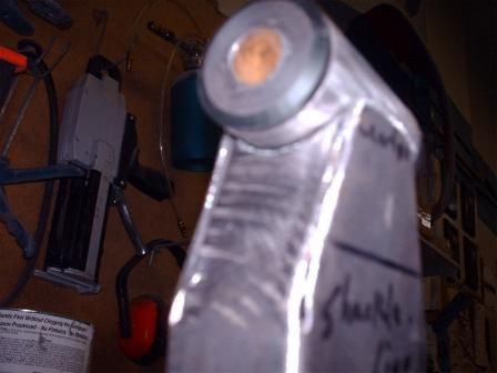

so .... wee ... progress today .
cut a couple of pieces off ..
also the brake line mounts .
ready to go ...

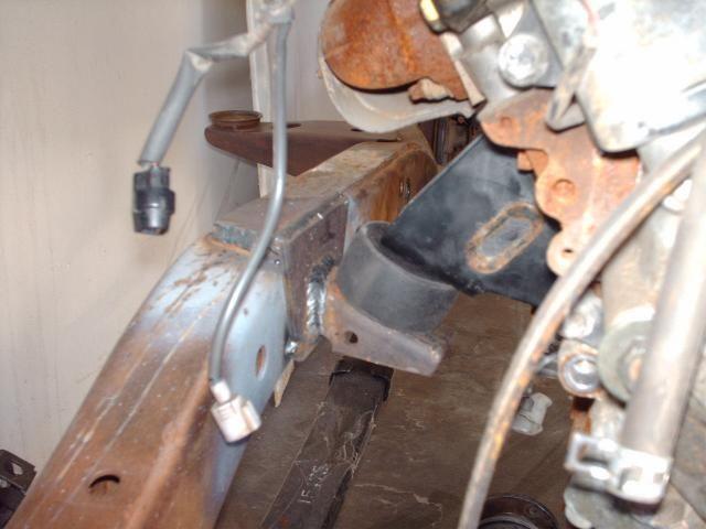

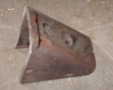

so started working on the motor mounts .
after weeks of shopping , and 1/2 as$ looking around , I finally found the mounts I want ..
They are just perfect ... and exactly what i have been looking for .
They fit the original mounts ..
and "hang" exactly where I want .
I started on the frame side mounts , but had an issue with the press . ... so I had to stop here .
What I have , are the 20r,22r& re engine mounts ...................
I cut them to fit the angle of the frame , and the angle of the mounts ... ( paper cut-outs & tape)
I'm making a frame bridal/bridge now and got them all cut out .. and ---- no press ...
so had to stop there . untill I can fix it ....

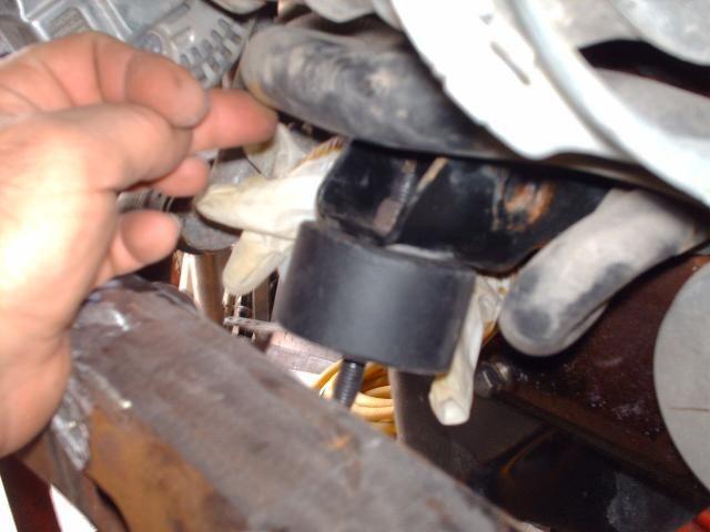

so ..
heres what we got so far .. I intend to add some gussets when i remove the engine to do the frame , but here's the "jist" of it .
also got a little delivery today ..

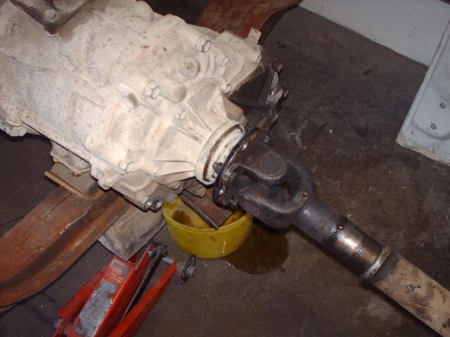

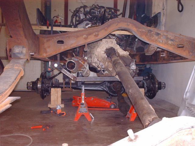

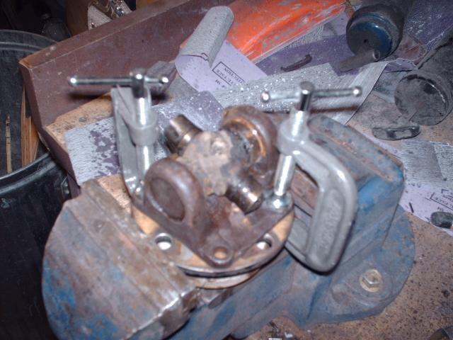

got to work on the drive shafts today ..
started with the front ... hung the original 95 shaft , and no way . CV would not bend enough . So I decided to compare .
angles are WAY different for some reason ? and not sure whay Toyota would change this .
The 95 -> has a lip on the inner CV ball that restricts any "extreme" angle .. so /95 shaft it is not going to work .
you can clearly see the differance . (not sure on the 84-88 shaft , dont have one)
so now to line things up .
front flange works (of course , diff side) but the rear (transfer side) has the 10MM studs .. with just a few measurements , I found you could knock out the flange studs . and using the 79-83 8MM drive shaft bolts , it'll line up . I was worried about the differance in the 10mm original , and the 8mm 79-83 .. but if you look at the flange/flange , there should be no movement .
so .. now FRONT DRIVE SHAFT ON . , I may have to lengthen , not sure yet .. but it's on
rear was not so difficult .. just had to drill the flange . set it up , and drilled .
finished
and installed .
so NOW I can build my crossmember .

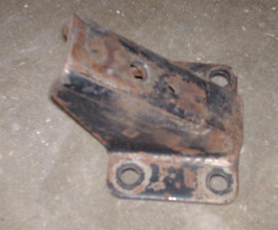

got a little done on the crossmember tonight ..
started with cutting off the original mounts
also got some frame plates cut , and "placed " .
also got the "mounts" completed ..
then made a "trace" of the original mount holes , and cut the lower crossmember
thats it for tonight .

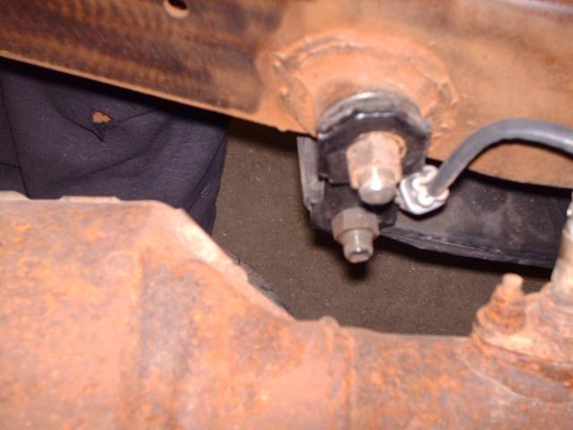

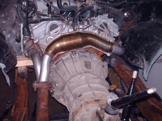

ok so .. here's why the hold on the crossmember .
I layed the "header" pipe where I thought it should be , had to watch out for the shackle clearance and such , and sure enough , it would have hit the crossmember .. so I think I have the crossmember figured now , but I figured I might as well get the crossover done , and in place first .
heres the pic of the cat , and the shackle clearance ... just for referance .

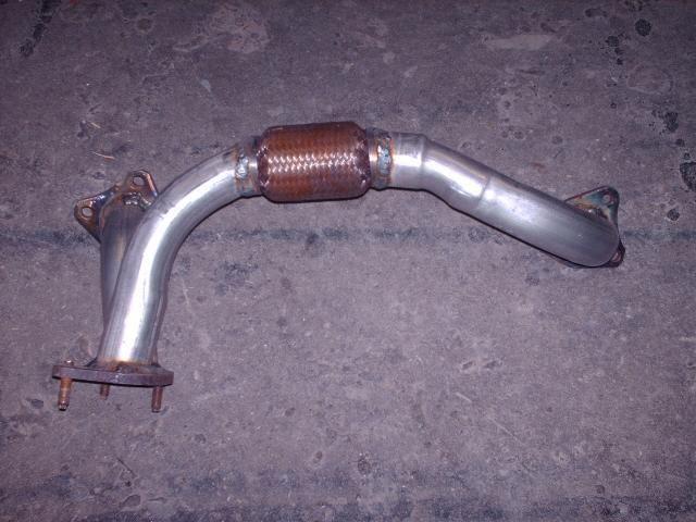

so I chopped up the old crossover ..
some guys have "re-worked" the old pipes , and expansion joint , I decided to go all new .
cleaned up all the old flanges , and put them in place ..
made a "template" of the first pipe , and ran of to get it bent .
trimmed it up , and cut it to fit ..
the stick indicates the firewall
pipe #2
and pipe # 3
a little triming (a LOT of grinding)
and a tack here and there , and finally I can weld .
I talked to the muffler shop , and the pipe bender guy suggested staying with the original Toyota flex joint , as they are WAYYY better then the aftermarket ones .. so I cut it out , and re used it .
starting to weld ....
and fully welded ..
part of the reason for this excersize , was I really wanted to have the original heat shield back on .. and TA, DA ..
and some clearance pics ..
and water pipe clearance .
[SIZE="3"]total price ... $30.00 + consumables , and my time . [/SIZE]
now I can finish the crossmember .

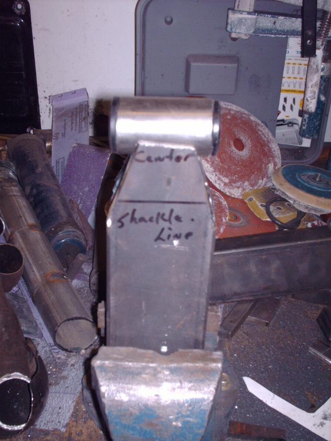

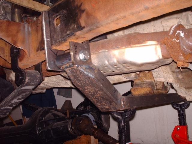

so got to work on the crossmember .
tranny mount is there , and now time for the frame attachment .
cut some pieces , and cut and ground and bend .. and heres what I got .
welding
LONG shot ...
lots of fitting and drilling cutting and fitting
cut some frame braces ..
boxed in the mount
and got er' ready to drop out .. long shot
added the protector plate , and strengtheners ..
clearance ..
and VIOLA .. DONE .
next on the slate .. and just arrived today
