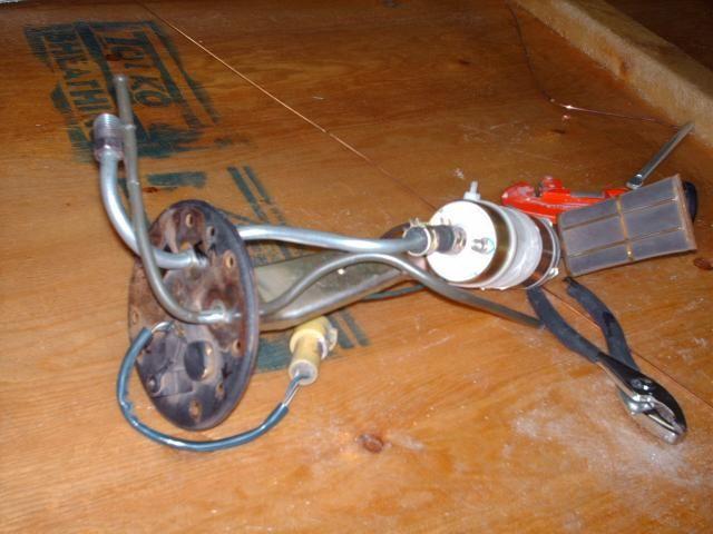

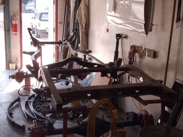

so a wee bit more progress on the POR treatment ..
and I have started to "BLOW" apart the suspension .. so I could get the frame done
.. when FINALLY .. look what shows up ..

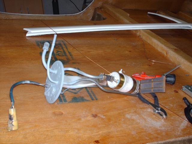

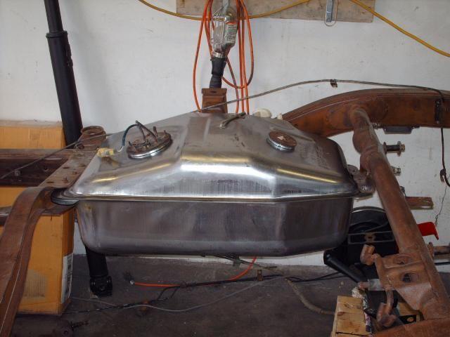

my new fuel tank ..
it's a bolt in .. and will accept the 84-89 EFI fuel pump bracket .. (mine needs a new pressure tube ) but it's all bolt in ..
Old Jul 9, 2008 | 04:37 PM
  #126
slacker's Avatar
Joined: Jan 2006
Posts: 6,382
Likes: 302
From: BC Canada

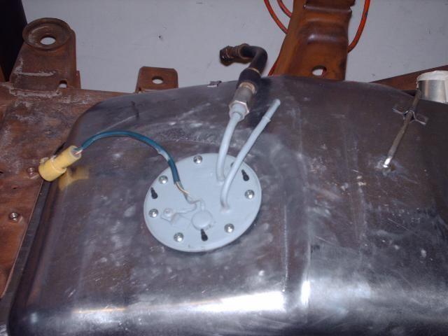

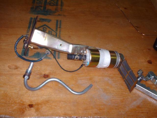

dont know if you can see in the previous pic or not .. but the pressure line on the sender is gone .. and the other pipe is rusted .. so
I had to fix .
I drilled out the old pipes , and started to manufacture my own .
The /84 holder didnt fit as "perfect" as I wanted .. so I bent the fuel pump holder , and fit .. bend and fit .. now it fits exactly where I want .. and to go with it .. new pipes .
bent up the PRESSURE pipe ..
and the return line
saudered , zinc'd and installed ..

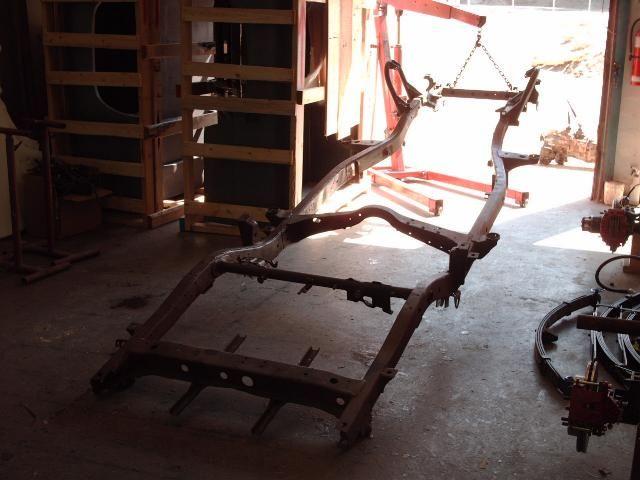

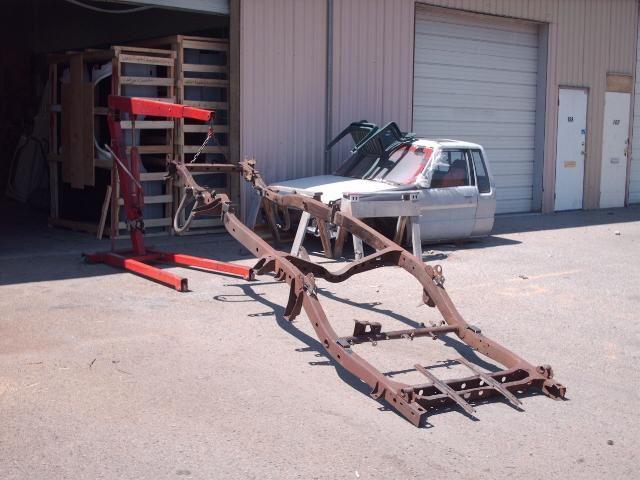

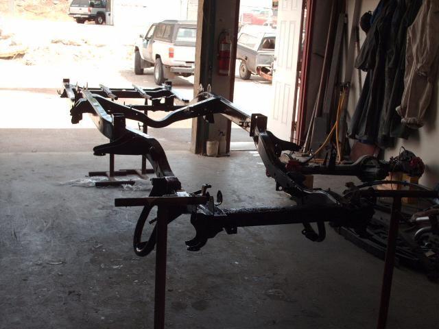

so frame is stripped again , and going for the final welding , and POR-15 treatment .
to today , I got the frame ALL welded ..
topside ...
and bottom side ..
rolled it out side , and got the washing ... drying ... degreasing, rincing .. degreasing .. rincing .. and washing again ..
and now I think im good to go ..
dragged it back in .. and did the "metal ready"
just another rince and dry tomorrow , and its ready for the POR -15 ..

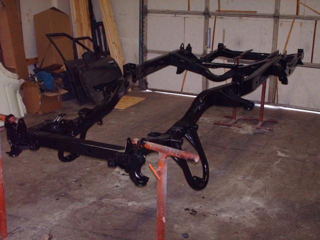

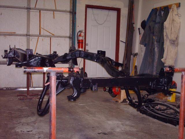

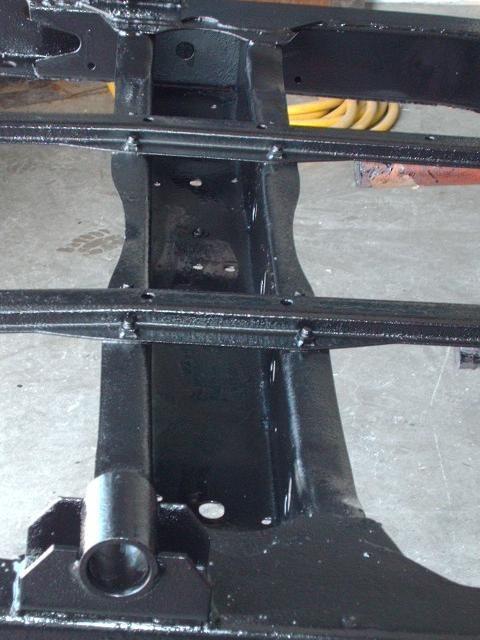

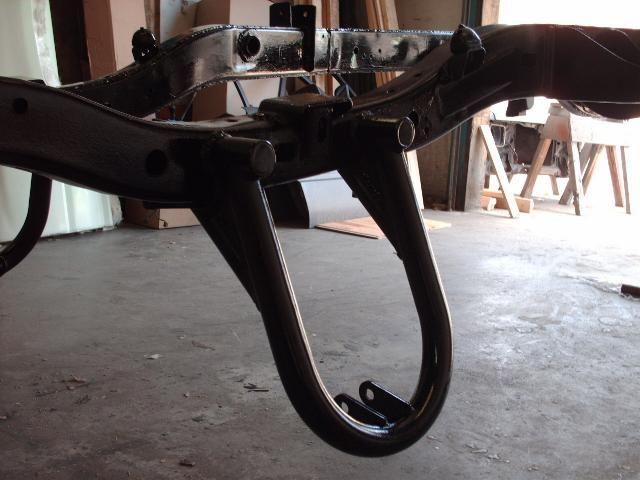

got the frame done today using my "gun" and a small paint brush ..
2 wands .. first is a rotating 360* "V" notch . Second is a 90* rotating .
I'm VERY happy with the way it came out ..

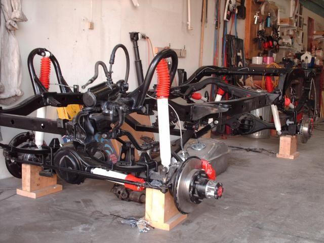

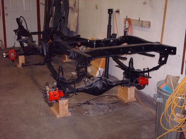

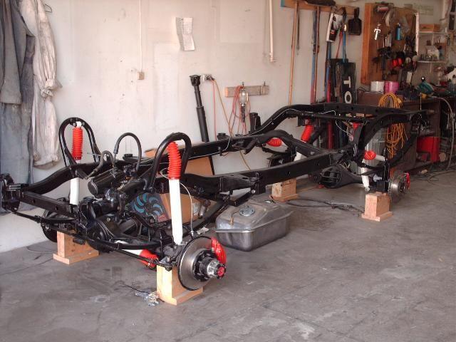

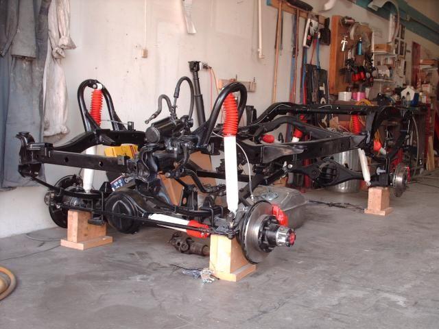

so started putting it all back together ..
all new hardware , or cleaned and zinc'd
also got my shocks today ..
so had to get them installed .. loosly .
