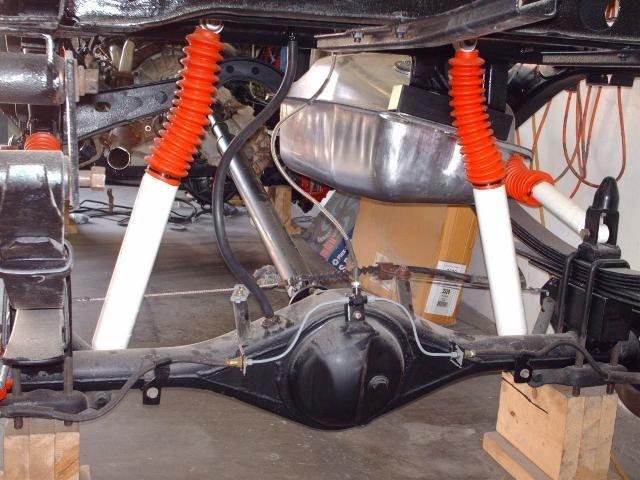

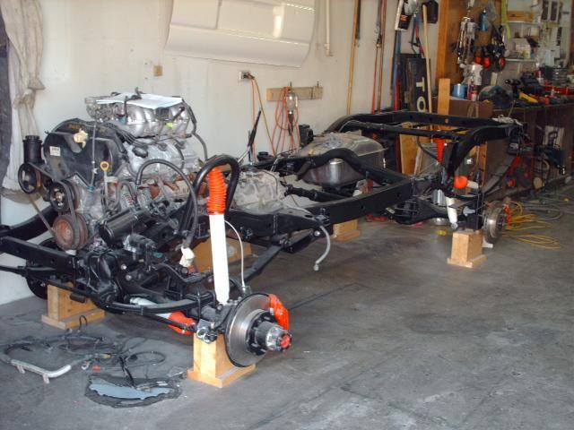

Whats with the rear shock setup?
Old Jul 23, 2008 | 06:47 AM
  #143
slacker's Avatar
Joined: Jan 2006
Posts: 6,382
Likes: 302
From: BC Canada
Originally Posted by shaw_j
Lookin good!
thanks ..
you havent been reading and following along !!!
they are "kicker shocks" , because of the spring blocks , they will control spring wrap .

I hate to be the one to break the news, but shocks, don't controll anything. Shocks are made for dapening whether used in a standard configuration, or mounted sideways like a stabelizer. IMO You wasted your money. You could have bought a antiwrap bar to do the job correctly for what ya spent on that setup.
Old Jul 26, 2008 | 06:23 AM
  #145
slacker's Avatar
Joined: Jan 2006
Posts: 6,382
Likes: 302
From: BC Canada
your exactly right .. it will dampen/control the spring wrap .. it wont be "harsh" like a traction bar .. personally , I like that better.
I ran them for 12 years on my old rig , and they worked just fine .. so I know I didnt "waste" any money . but hey , everyone has an opinion , and there all welcome .

I get massive amounts of spring wrap which im trying to fix. Ive been thinking of AAL to cure it but i want to see if this idea works. Anyways keep up the good work and maybe ill see this Trekker one day

Take off the shocks boots!

Nope .. to bad so sad , I like em !

I cant read everything.. I see now, good idea!
Anti-wrap half leaf is the best means of control, short of fabricating a torque rod (which would be the absolute best). Half a leaf (fairly stiff), top of pack, extending from the u-bolt plate forward almost to the front spring hanger, held at the front by a spring clamp available from any NAPA etc.

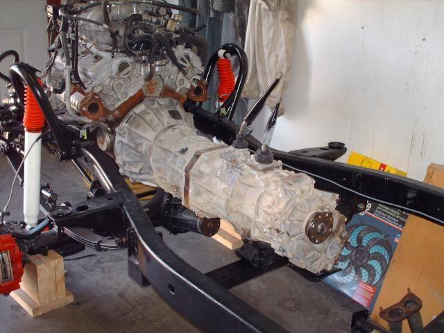

so not much to add today .. but a bit ..

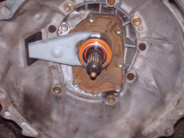

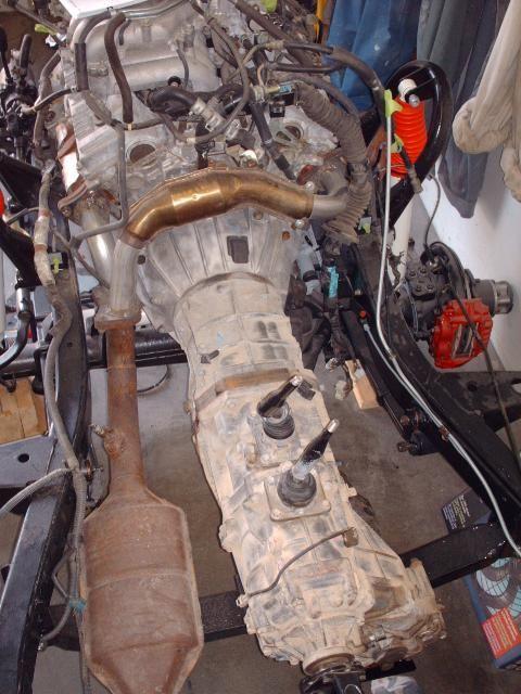

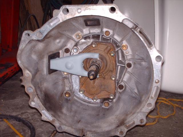

dropped the engine back in place , and started on the transmission .. and clutch .
blasted the fork to check for cracks and such .. , and then zinc'd

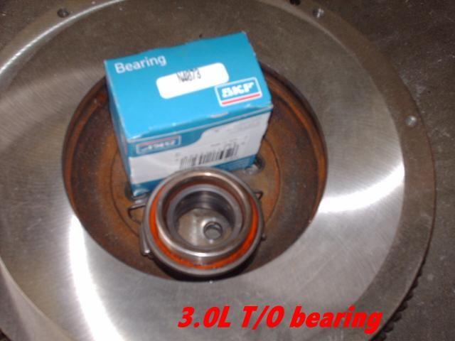

on this swap , you will need to use the 3.0L throwout bearing ..
greased the fork , and inner bearing surface , and installed .

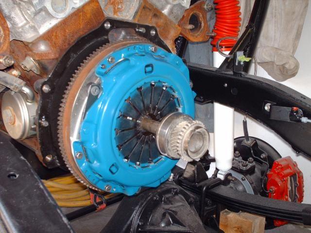

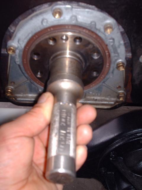

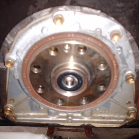

installed the pilot bearing ..
the 3.4L clutch installed ..
with these kits you get a "goofy" plastic alignment tool .. but I like to use my own .. an original input shaft .
and finally the tranny back in place ..

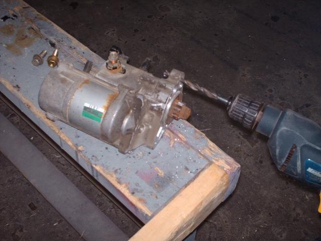

also mounted the starter ..
on the bottom mount of the 3.0L belhousing .. it is threaded .. so is the starter .. you I had to drill the threads on the starter so the bolt would go threw
very simple

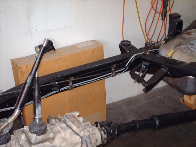

re & re'd the ATM wire harness , for the MTM harness ..
also installed the front shaft .. had to remove the transfer flange because it has 10mm GRD11 studs , and stock 83 is 8mm .. so same as the rear shaft , I had to drill .
also mounted the front of the exhaust again , to get ready to build the rear ehaust pipes , and muffler ..

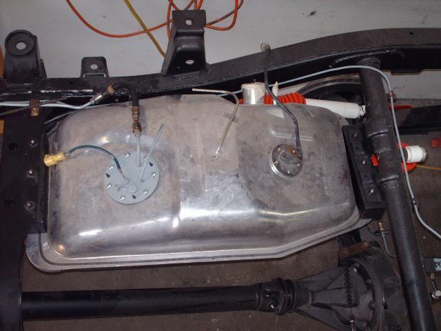

also fully mounted the fuel tank , and installed senders , and pump for good ..
I think thats it ..
