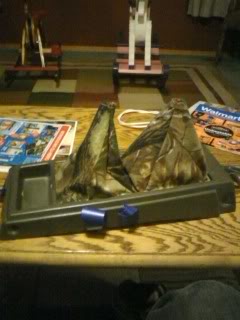

do what i did

Originally Posted by davo247d
do what i did
what did you do ?
Old Nov 17, 2009 | 05:19 PM
  #684
davo247d's Avatar
Posts: 493
From: Helena Montana
haha i got my mom to sew me up a camo shift boot (mostly because i cant sew) lol
