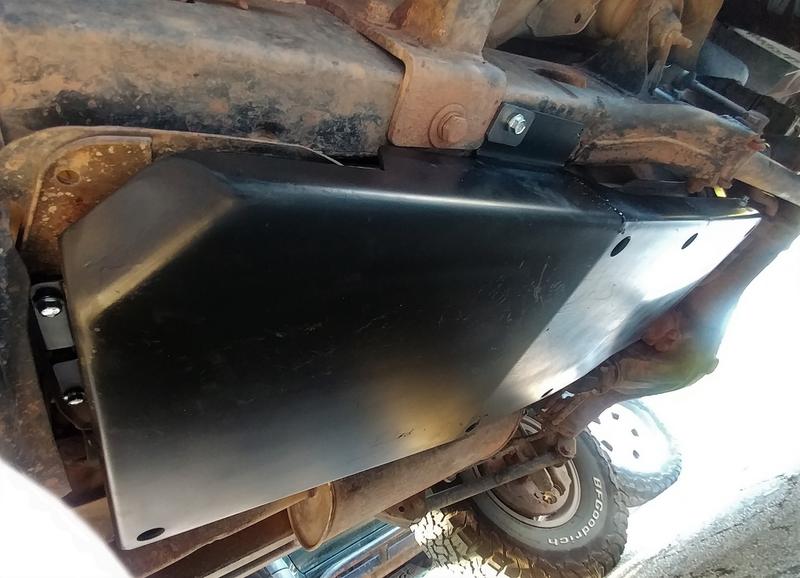

Bolted up the Lil Skips gas tank skid that my husband gifted me. He knows what floats my boat.
I measured and he cut a part of the front drivers mount flange off to accommodate my bolt-on skids.
I did find my right rear tank and skid mount is bent a bit, but the skid bolted up so no worries.

That skid plate looks good. Really good! Actually, way too good. Skid plates should be scratched, dented, dinged, etc. Your truck is crying out for some off road abuse. It's what they live (??) for.

I just painted the skid! Don't worry, the pretty won't last long.

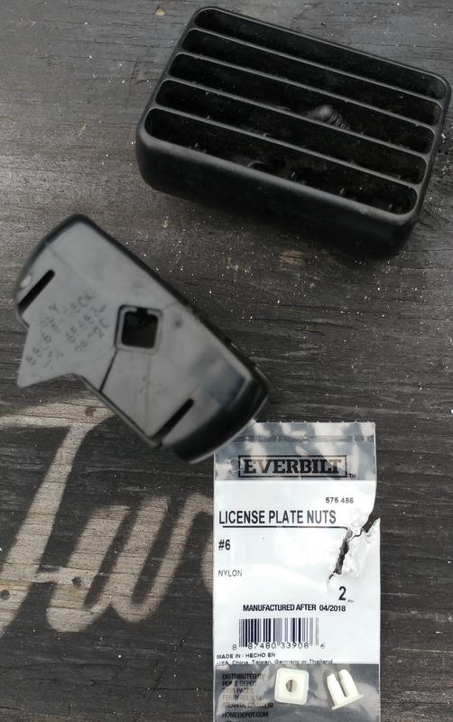

Still haven't figured out the SRS airbag light, did find a procedure to reset the light without the pretty (expensive) Toyota tool. Haven't tried it yet, can't find the years the procedure is for and feel the need to do more research.
Today I spent a little time piddling about the trans/trans/trans, tucking wires out of the way and such. I also made some new vent bearings, those little square things that keep the vents from being floppy and also that fall apart. I used Everbilt #6 license plate nuts and modified them a lot. The hole had to be made bigger and the back shorter and the sides narrower. Eh, they seem to be working, but something that fits better would be nice.
