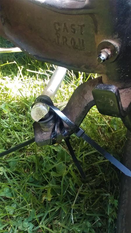

2002 Scotts Kohler engine 42" deck lawn mower L1742
Heh, my lawn mower is 6 years newer than my 4Runner...
I was mowing yesterday when the left wheel suddenly went for a left turn while the right side was still on the strait and narrow. The ball joint on the drag link separated.
I fixed it well enough to finish the acre I had left to do.
Viva la zipties!!!

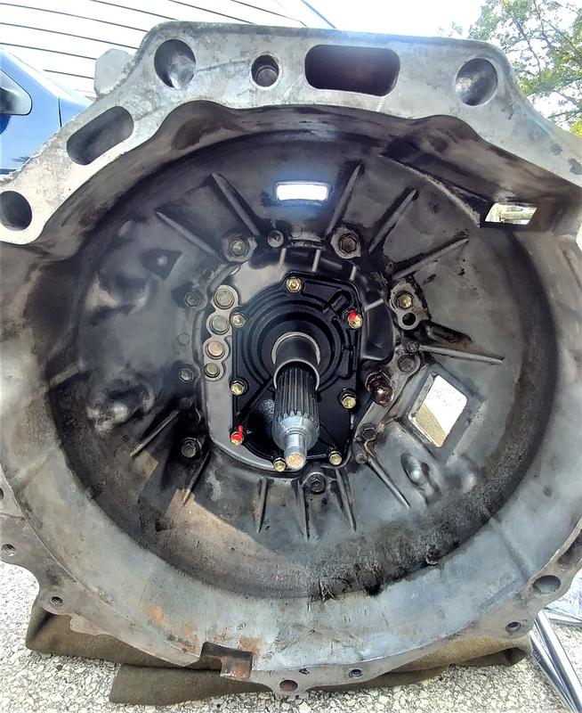

EDIT: Marlin'd sent the wrong seal with the original Taco Box kit. It was not able to keep the trans fluid in the transmission, just out to the Taco Box and from there up and out the shifter. I couldn't have kept enough oil in it for the trip we took without stopping every 25 miles or so. Highway speeds were the biggest issue. The second transmission had the correct seal, which made a big difference.
I sent the transmission back with their coupler, housing, and seal that I'd installed still on it. They said it all looked correctly done. The seal was in good shape. I did toast the transmission (because I'm an idiot and I am kicking myself for it) by running it near out of oil until it was too late to save. That last long drive from mid Colorado to eastern Missouri (with added oil) definitely did not make it any better. I kept checking the taco box in the mornings when it was cool, but not the transmission. No good very bad me.
They left the coupler housing as is because I'd installed it correctly, moved the coupler over to the new output shaft (so pleased I don't have to do that again!) and I noticed the new seal they installed is different. More metal, less not metal. I guess they've decided to give a different type seal a try since nothing looked wrong. Anything that works is fine by me!
I got home from work and installed the transmission on Thursday evening, but I ended up with another shifter base that was too short and it won't work with my oe shifter. They've located my original base and are sending it to me.
Once again the shifter initially wouldn't shift into any gears so I had to move the reverse shaft rearwards via the hole for the reverse light switch, but that's easy enough. Apparently it's common for it to move during shipping. Once I did that I found the problem with my shifter being too long for the base and binding up against a shaft in 4th gear. If I pulled the shifter partially up it would shift again until it went into 4th gear.
You know I'll be watching for fluid and checking ALL the things if it happens again!! I'm not a fan of feeling stupid.

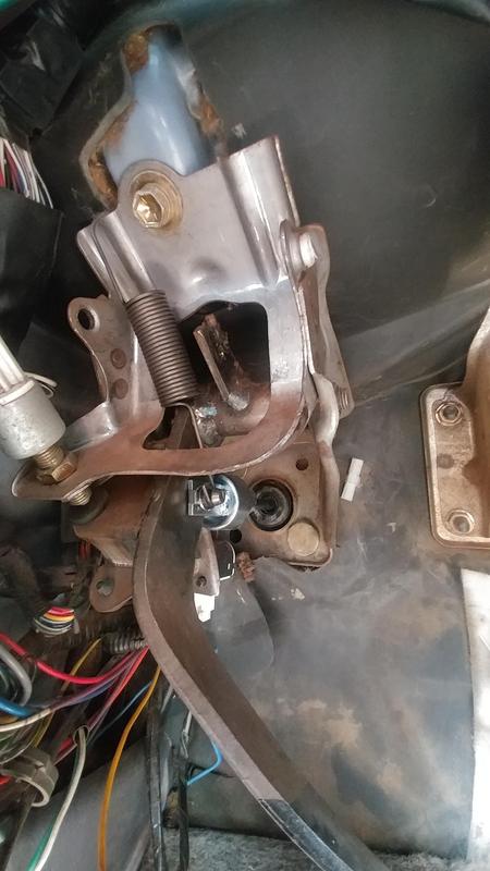

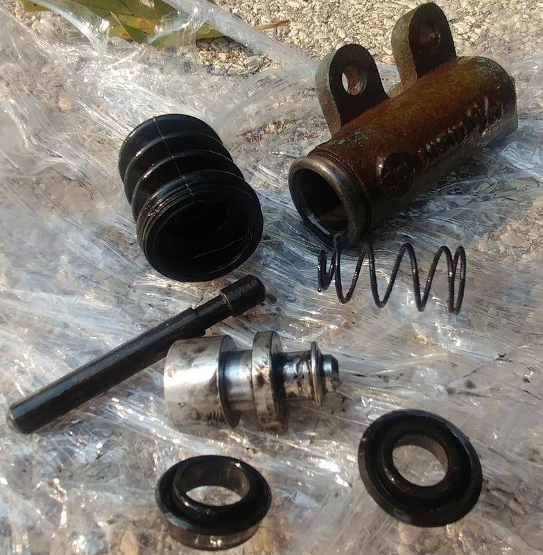

In the meantime I also bought a clutch master and slave cylinder. I'd already replaced the clutch hose. It wasn't hard to do.

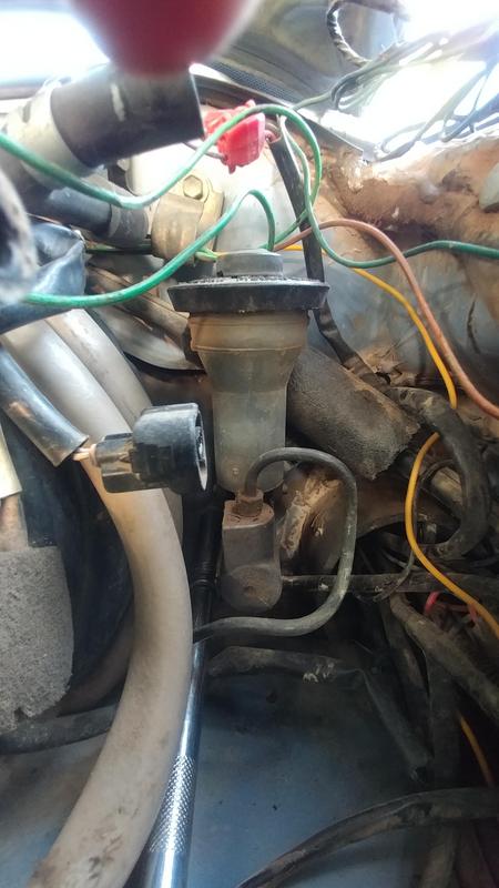

First I removed the pin that holds the clutch master shaft to the clutch pedal arm.

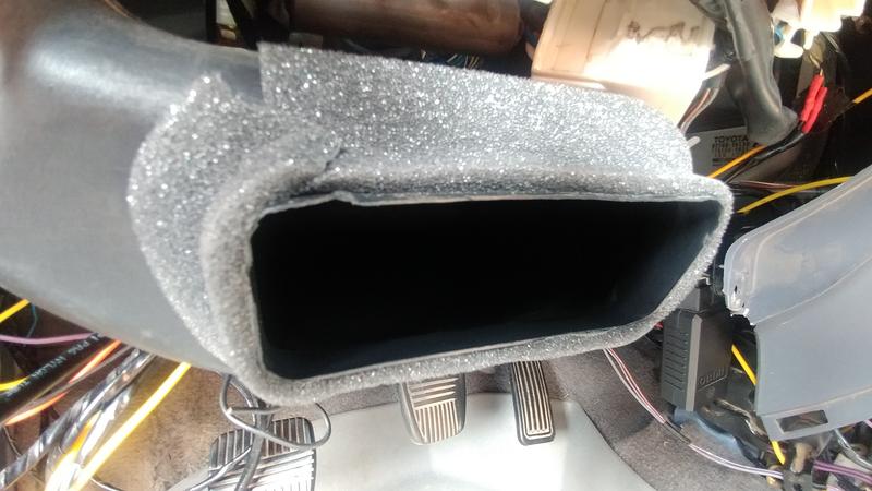

For room I removed the moo box (charcoal canister) from the engine bay.
After removing the bleeder valve from the clutch slave and draining the system
I removed the hard line from the clutch master.

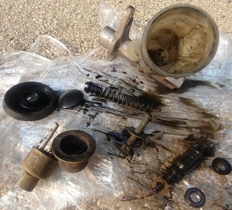

There's just two nuts that hold the clutch it to the firewall.
There's a paper gasket in between, one didn't come with the Aisin part. I used a little FIPG since I didn't have gasket material on hand to cut one and didn't want to wait for the local parts department to get one in. It probably could have done without especially with my drain keeping most of the water out of that area, but there you go.

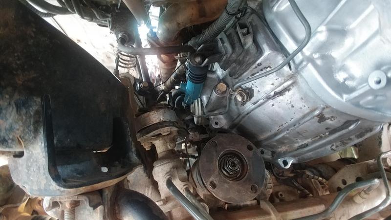

Next I removed the hard line from the clutch slave, then unbolted and removed it.
The new parts went in easy enough, I made sure the 'U' that fits around the clutch pedal arm went in the right place, then bolted the clutch master to the firewall.
I also tried to match the new and old clutch master actuator shaft length so adjusting would be easier.
Next I re-installed the hard line to the clutch master,
then bolted the clutch slave to the transmission,
re-intalled the hard line to it,
opened the bleeder screw and gravity bled the system.
Closed the bleeder screw and checked the fluid level in the clutch master reservoir.
This morning I double checked for leaks and put the pin back in through the clutch master 'U' and the clutch pedal arm.
I'm using the clutch pedal spring delete, so installed the 'new' spring.
And that's that.
And that's that.

Re-installed the bell housing I took off before I shipped it in. 9 bolts, 27 ft lbs. I did it in a pattern though it probably doesn't need it.
The clutch master tucked away in the left rear corner of the engine bay. You can also see my half-round of silicone hose stuck to the firewall to prevent water from coming in through the wiring grommet.
And the pretty new blue clutch slave bolted to the side of the transmission. There is a large bolt that holds the bracket, plus two small bolts that holds the hard line to the transmission
Clutch master exploded because I can't help myself
Clutch slave exploded. At least I have an M.O.
The clutch master had some nasty black goop at the bottom of the reservoir. The clutch slave seals were rubbing off a little black goo on my fingers.
My clutch pedal arm with the 'U' keepered in and the clutch spring mod in place.
After that was all done I put my dash the rest of the way back together, bolted up my steering column, finished my a/c ductwork including the bits cooler (I don't have those other things to cool).
I also got some of the wiring under control.
