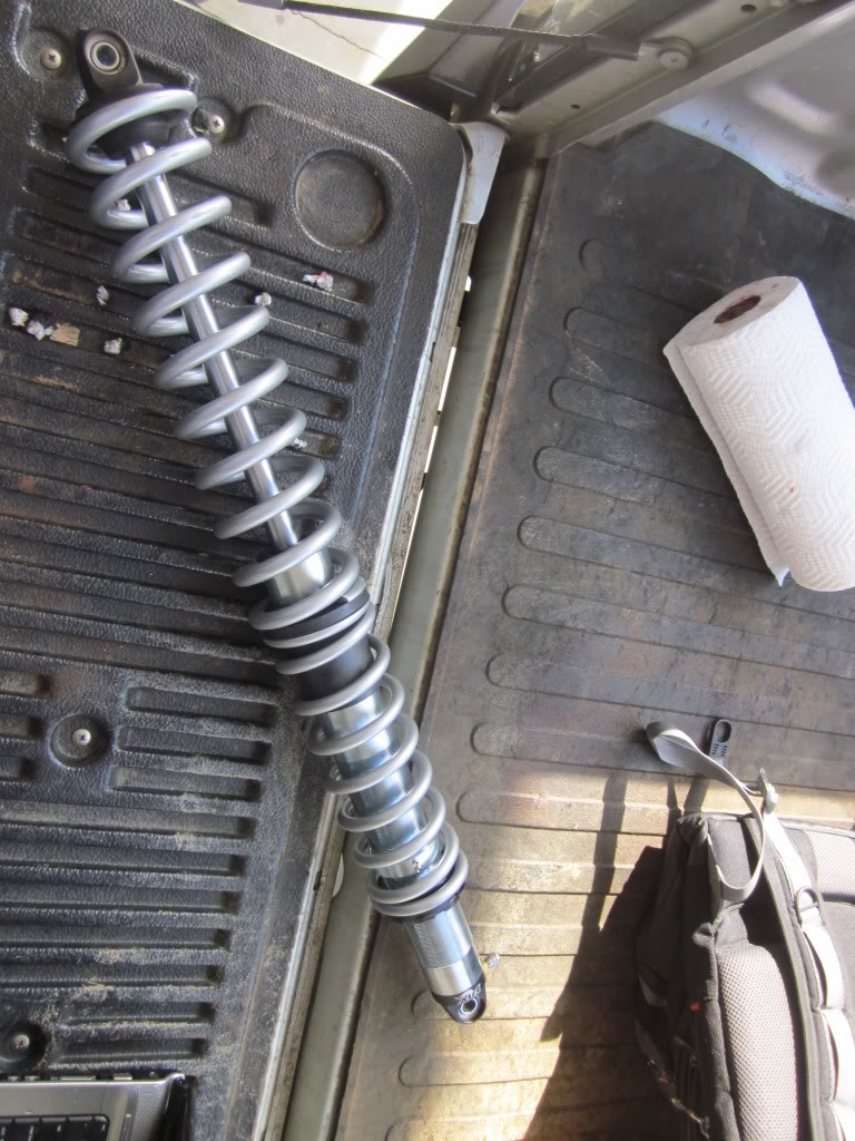

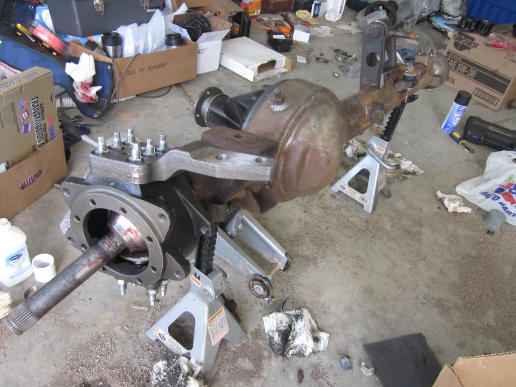

Just a little update, everything is together and ready. The truck goes into the shop the 19th to start the swap. The axle is built/geared/locked, I have the coilovers and everything for the steering swap.
Built 79 axle, 4.56 gears, Spartan locker, TG Six Shooter knuckles, new bearings and seals, and 79 FJ40 vented rotors.

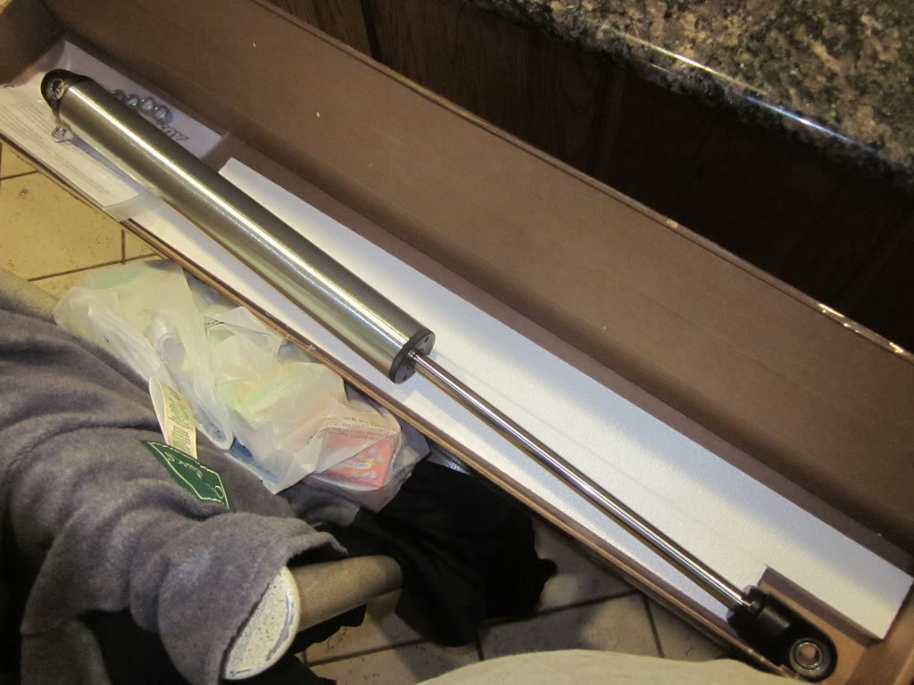

Fox 12in travel, 10in top coil @ 250lbs, 14in bottom coil @ 350lbs

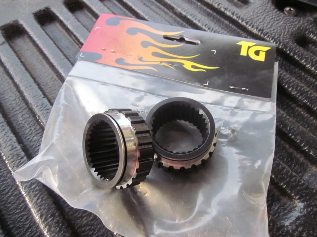

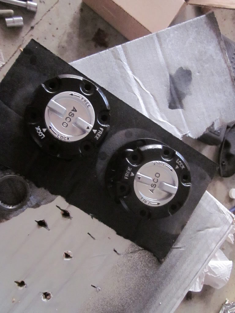

TG Chromo Hub Gears and the stock ASCO (79-80) hubs rebuilt

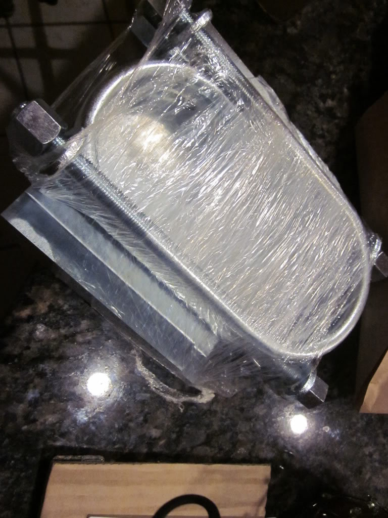

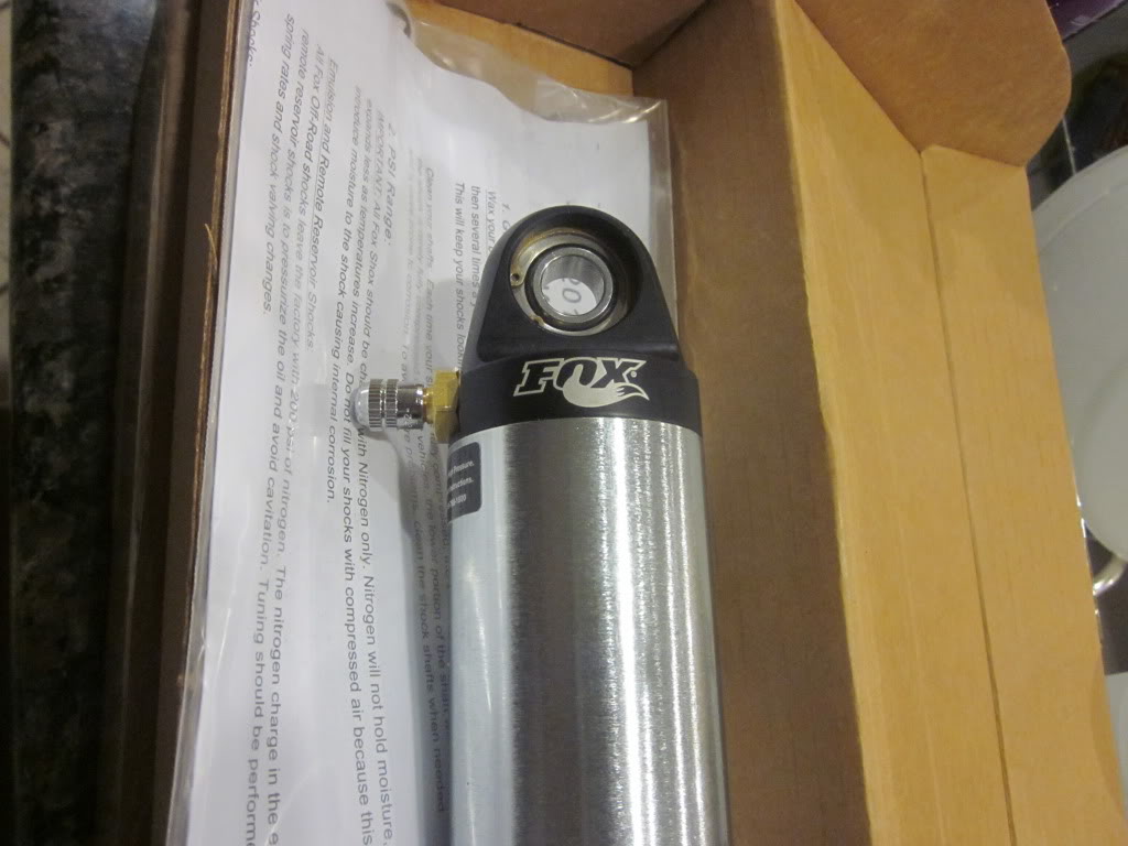

More odds and ends...
Fox 2.0 --> 12in travel
U-bolt Flip Kit
Spring Retainers

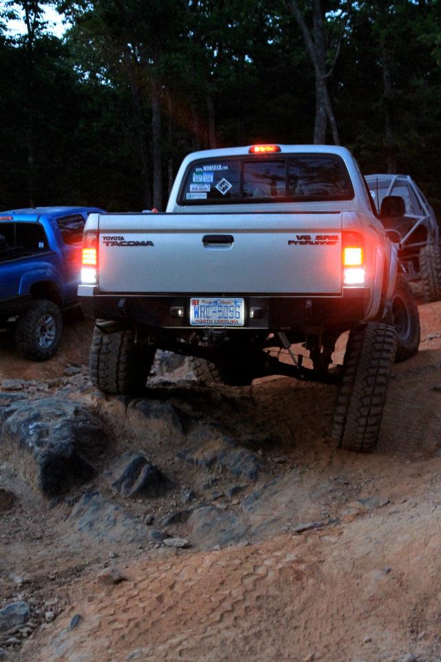

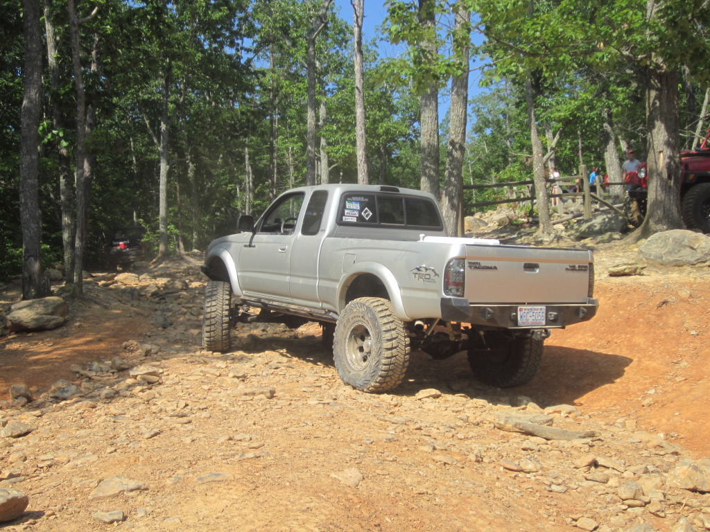

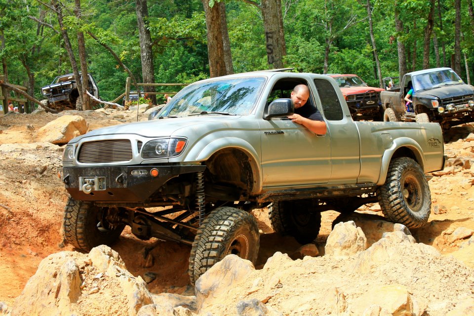

Just thought I would post an update of the finished product. I'm very happy with how it turned out. I handles great on the road and is very stable on the trail. I'm still getting used to how much flex it has.

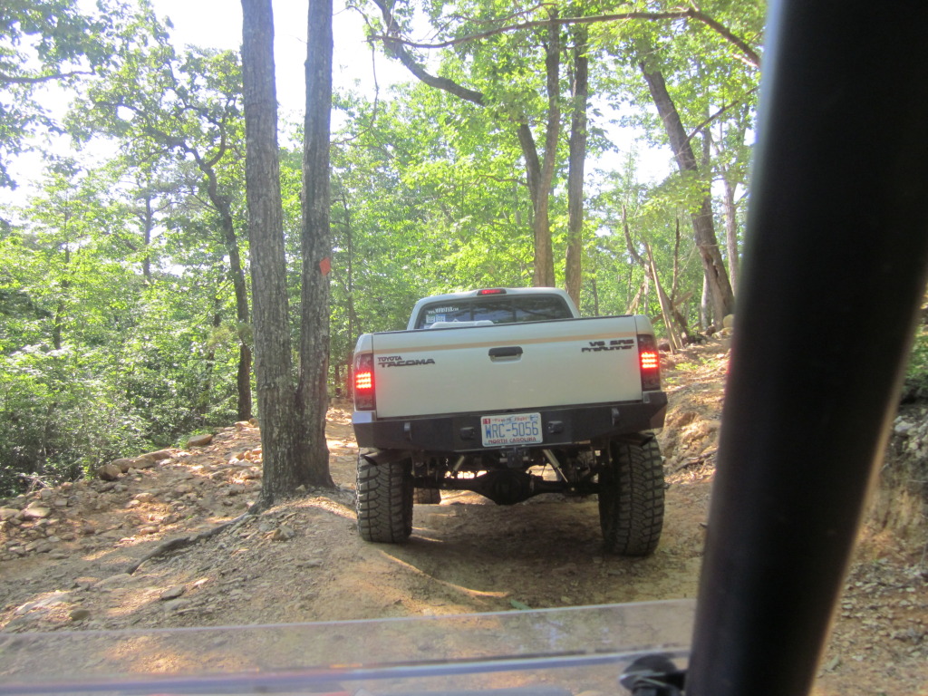

Here's a few other pics from last weekend...
