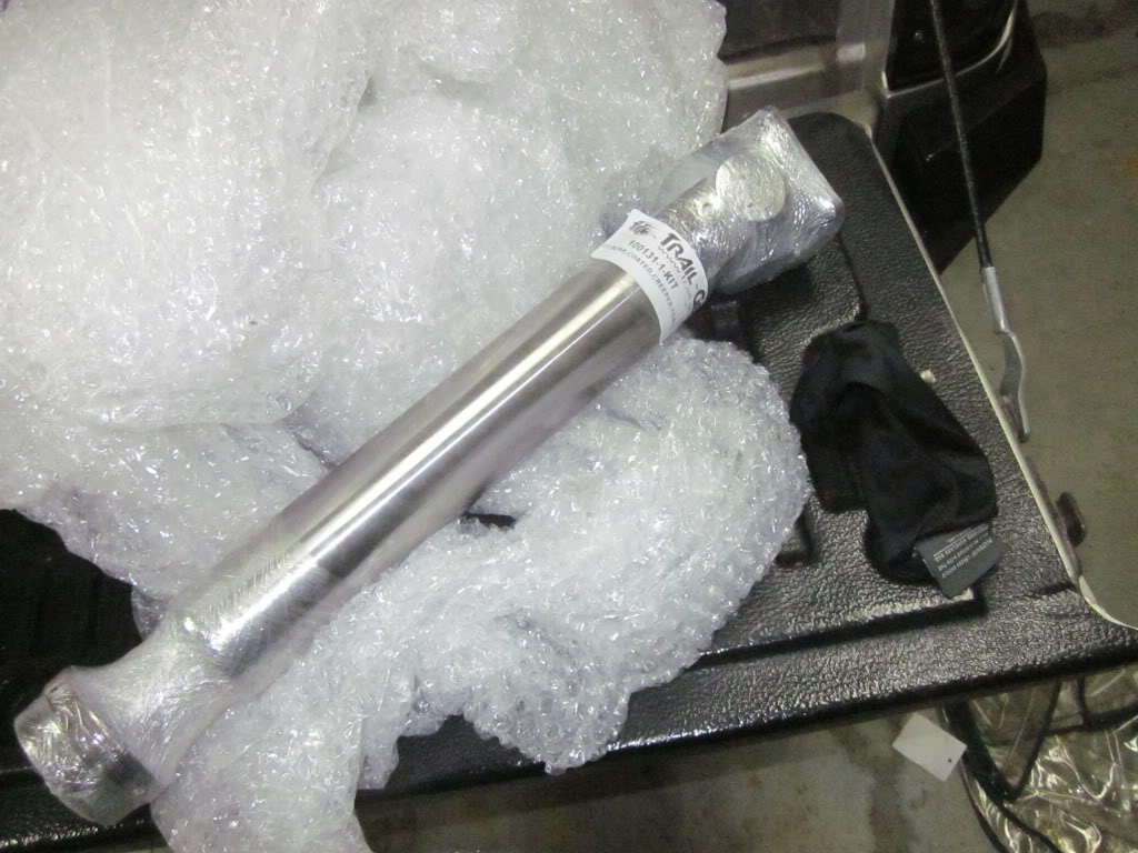

Trail-Gear heavy duty driveline with Creeper joint

It's coming together nicely. I'm dropping off the case and the 4.7's to let him go ahead and get them in, and thursday I'm doing the transfer case swap... back to 2wd status for me
