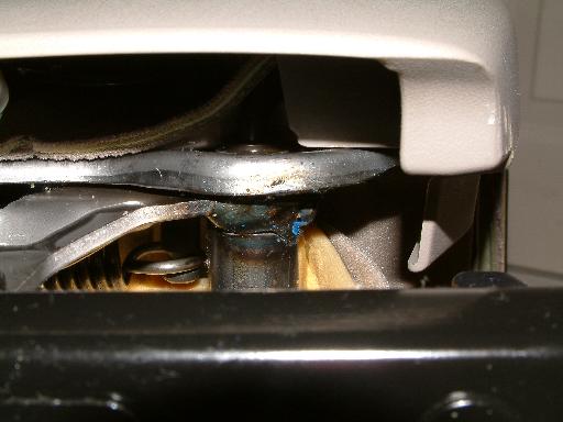

Curiosity got the best of me, I just had to figure out why my driver's seat clicked, bobbed, weaved, bounced, jiggled, etc... especially after I brought the truck in for service and specifically requested that they fix the problems I was having with the driver's seat.
Closeup view of driver's seat rear crossbeam showing crack at weld on left side:

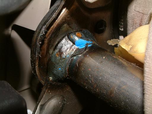

Closeup view of driver's seat rear crossbeam showing crack at weld on left side, viewed from the bottom:

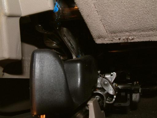

Rear passenger "Foot's Eye View" of front driver's seat rear crossbeam showing crack at weld on left side:
Lets see the dealer :pig: try and adjust and lubricate his way out of this...

I have to remide everyone that I drive a '92 Integra, which I think was designed for a much smaller person, and I have not had any issues like this with the drivers seat, even after 190k miles.
Any scientists, metallurgists or welders out there? What I think is the likely cause is that when the seat frame was fabricated, the welder used too hot a flame and cooled the metal too fast causing it to become brittle.
