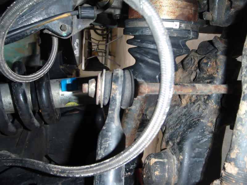

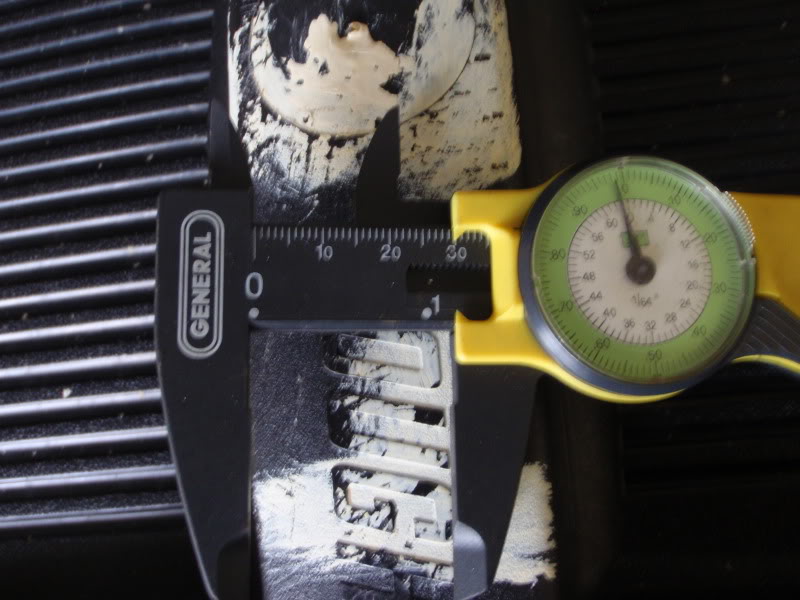

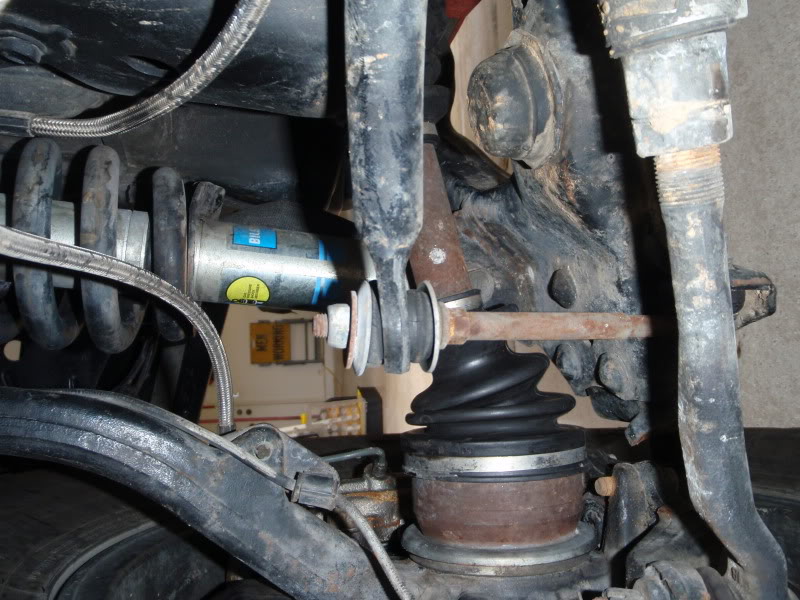

Ok the end links or links according to Toyota. So as previously stated the END LINK bushing is what I'm curious about. The entire thing OE will run you $74 ea. from Toyota. All I need is the bushings and the red ones in one of the previous posts should work.

The overall (difficult to get a good read) measurement of the bushing (lower one) is 30mm +/-.
Aaron

Yup then you want the 3/8 ID bushings from ES pt # 9.8105
https://www.yotatech.com/forums/f2/i...ushing-105193/
http://www.energysuspension.com/pages/endl.html
