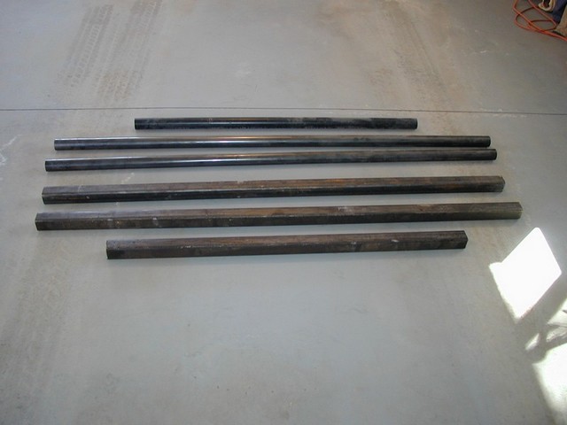

What can I build with this stuff????
Just kidding I know what I am going to build.
BTW, round stock and square tubing sure has gone up in price!

Old Mar 9, 2004 | 01:46 PM
joshik's Avatar
Joined: Oct 2002
Posts: 913
From: bellflower
a rear bumper!

Old Mar 9, 2004 | 05:09 PM
PutzRunner's Avatar
Joined: Mar 2003
Posts: 300
From: Johnstown, Colorado
Originally Posted by maddmatt02
are yopu going to have the square or the round stock as the outer rail?
The round will be the outer rail and the square will go under the pinch weld.
Don't know when I will finish this project but they will be bolt on for sure.

Old Mar 11, 2004 | 07:02 AM
PutzRunner's Avatar
Joined: Mar 2003
Posts: 300
It's gonna be SLIDERS!!!!
I am still thinking if I want to go with bolt on or weld on.
Right now I am leaning to bolt on. I thinking of making a
saddle that will go up both sides of the frame and then put
sleeves through the middle of the frame and bolt all the way
through the frame.
However, with the fuel tank so close on the drivers side I may
have to go to self tapping bolts in that one place.
I will let everyone know how they turn out.
Old Mar 11, 2004 | 10:20 AM
maddmatt02's Avatar
Joined: Feb 2004
Posts: 154
From: clinton, WA
when I do mine I am gonna try to make the rails that go to the frame have a sleeve that fits inside of them snugly, might have to use the lath and turn em down a bit so that they will since I.D. arent guaranteed when you buy steel pipe. but then weld the base plates to the sleeves, slip em in the rails and hold it where it goes, weld on the plates/sleeves and then drill a coupole holes in each rail through it and the sleeve and get some strong bolts and kep them o like that, then it is welded to the frame for a better connection but I can still remove them if I want to. or maybe just put a sleve through the frame everywhere but at the gas tank location where you cant and only do the sleeved inner raisl right there, cuz I know I dont wanna just use self tapping blots wiht no nut on the back.
