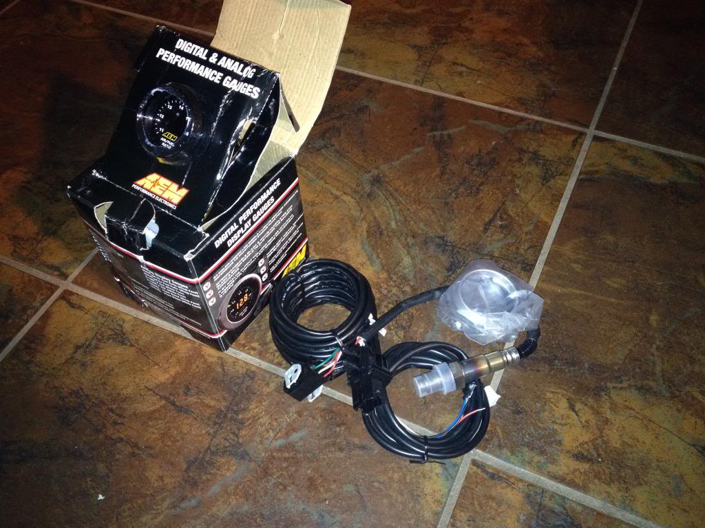

I'm not interested in pushing it any further. I want to add a wideband so I can crank it up to 7psi with confidence. I want to add methanol injection, TransGo shift kit and possibly a stall upgrade. But that's really just tuning for reliability and longevity.
