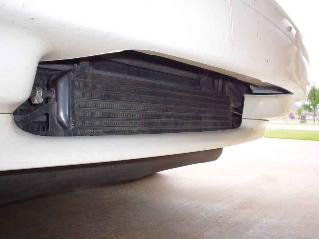

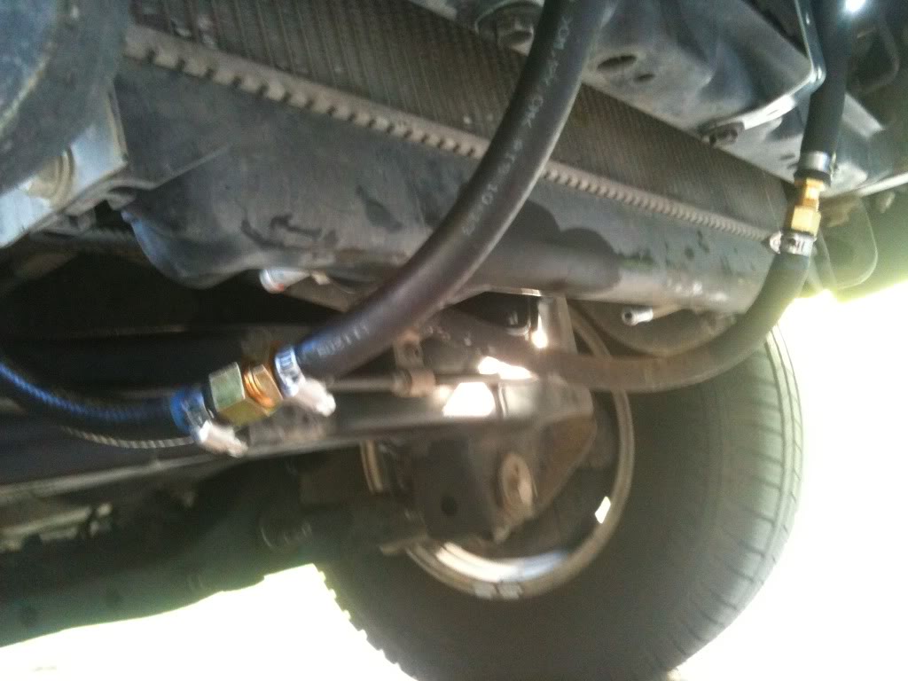

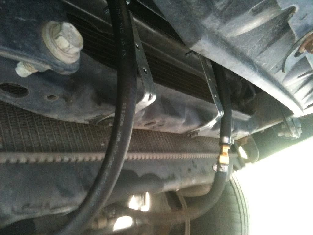

Here's a couple pictures of my cooler installed. I didn't take them when I had the bumper off, so it's kinda hard to see where the thing itself is. I need to get some more hose and re-route the lines, at the moment I can't put the skidplate back on because of where they are.

I'm very happy with the cooler; I don't have a temperature gauge hooked up to my tranny, but I have noticed that my engine runs cooler now that the transmission heat is out of the radiator. The cooler itself definitely gets warm, and quickly, which means it's doing its job well in conducting heat. There is ATF on the underside of my chassis, and I'm not sure if there is a small (and I mean very small) leak, as I've been checking my fluid religiously since the install and noticed no drop in my level. I think most of the fluid is from the old circuit in the radiator, which I didn't cap off or fully drain.
Anyway, I'm glad I did this mod. I'll be posting some more pictures in a few weeks when I can redo the lines; Probably just gonna run a single piece from each steel line as opposed to using the multiple sections and connectors that came in the kit. But a big thanks to Yotatech for all the tribal knowledge!
