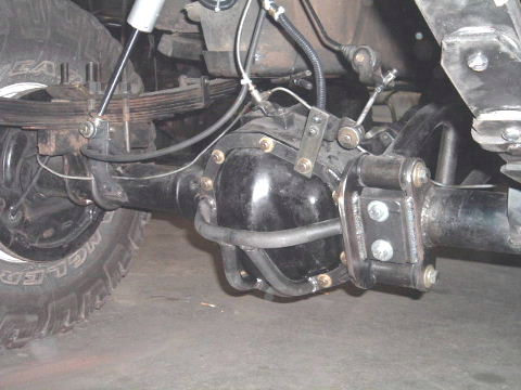

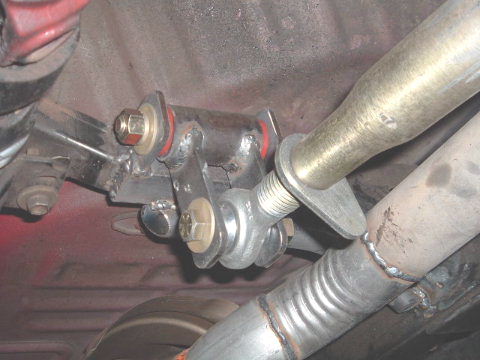

here's one I built for an SAS taco with a D60 rear end, the shackle and hiem are the key to flex
Attached Thumbnails Traction bars?-dans-diff-mount.jpg   Traction bars?-dans-shackle.jpg
