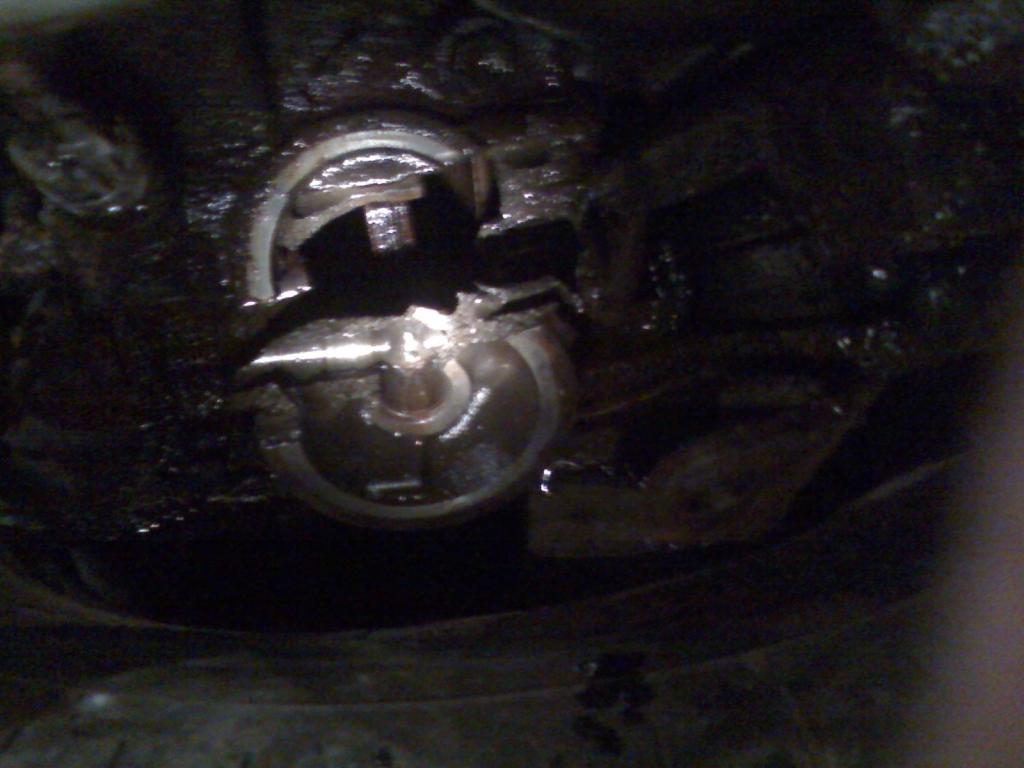

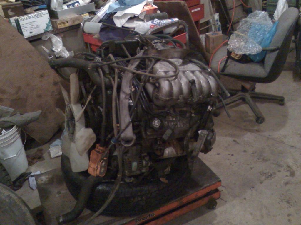

New motor
Old motor
Hole in old motor lol
Blew the oil filter and threaded nipple right off he'll of a mess getting the old motor out. I got the valve covers and intake cleaned up tonight and found some spray bomb silver looks better than they were. Had to switch out the exhaust manifolds and crosse over pipe. Apparently 99 and 02 are different. Will post more pics tomorrow
