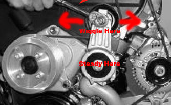

Noticed a small rattle yesterday that get's worse on acceleration. Took a look and a local repair shop confirms it is the tension pulley. It looks like it is shaking back and forth. I've attached this picture to demonstrate. Let me know if you'd like a video. Anyway, the top (pulley) portion wiggles left and right but the base is stationary.
It doesn't seem normal that this should wiggle left and right but I'd like to make sure. If this is the issue, how would you recommend I proceed? Purchase a new tension pulley assembly, remove the old one for further analysis, etc.

From my understanding, it's suppose to "wiggle" there on the "free" end, at least back and forth on the pivot that is provided by the "steady" end of the tensioner which is "fixed" as is needed to maintain the tension on the belt.
You should be able to test it for yourself by grabbing the tensioner's arm and attempting to wiggle it (it should be solid) and then the actual pulley itself and doing the same. If you discover "play" in either, it would be wise to replace it and/or them before you end up stranded and possibly with more serious problems.
If the play is just in the pulley itself though, you should be able to replace just it, as long as the arm is solid.

I'll check when I get to the truck again - but I'm pretty sure the arm is wiggleing a little. Thanks for the advice.

"...wiggleing..." is not good, but if it merely moves in line with it's pivot point, then your o'kay.

Yes, it is moving in line with the pivot point. A friend of mine (mechanic) took a look and said this was normal. We concluded that the rattle is most likely a bearing inside the pulley. Thanks for your help everyone.

It is definitely a bearing. A buddy of mine told me how to pry the pulley to the left and realease the belt. I then spun the pulley - metal on metal. Is it possible to replace just the pulley or do I need to order the whole kit (code: 00602-17620-090)?

Yes, you can replace just the bearing/upper pulley, without having to replace the whole tensioner arm assembly... or.... You could try george16's advice and see if the dealer will warantee it.

Called TRD and they gave me the part number (00602-17620-082) for just the pulley assembly instead of the whole kit. Phil ordered it for me ($38 yotatech price) and I'll be picking it up Tuesday/Wednesday. Lets hope nothing happens before I can get it changed out. Thanks for your conerns!!
