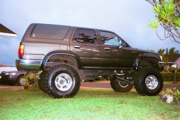

here's a 4 " suspension, 3" body on 35s...
from the islands..

I think we are looking at 3rd gen lifts...thats a sweet setup. Monica's I believe. But its a second gen .
