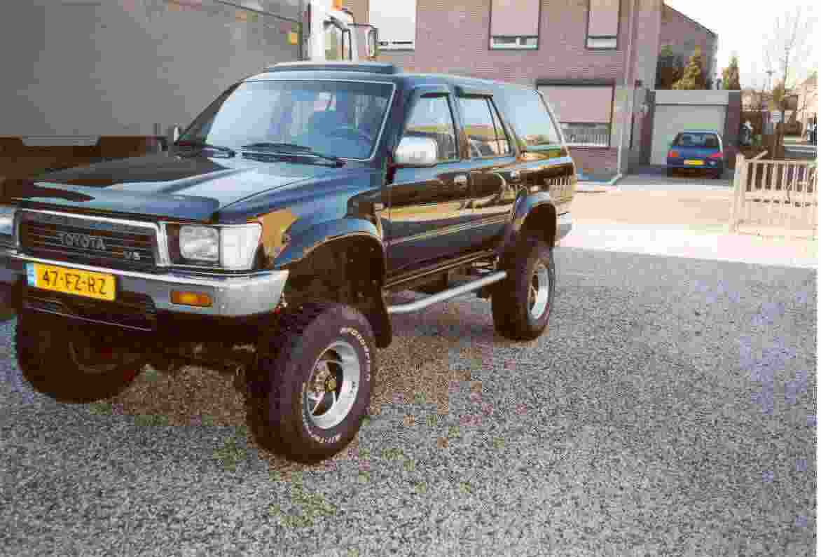

I've build a SAS with coil springs a year ago because I was fed up with the IFS (too soft, too weak, not enough articulation) but also with the leaf springs (way too stiff, but plenty strong). I drove a Hilux for 9 years with leaf springs front and back and 33's.
Nobody else out there who has done this also.

Your coil SAS looks pretty good to me! What year of truck is that on? DO you have anymore pictures?

It's a '90 4R V6. Sorry. I mean since a few weeks it's a '90 3.0 L6.
I'm almost finished with my supra swap. It looks preety standaard but has a SAS, supra engine, doubel diff lockers, electric swaybar disconnect, 4-5 inch lift and a massive stereo.

Not to burst your bubble, but spring SAS has been done. Yours looks really nice, though! Good job!

Very nice!
I just got done reading about your Supra-I-6-swap, looks great so far! It should be a very capable 4Runner when you get it finished, good luck!
