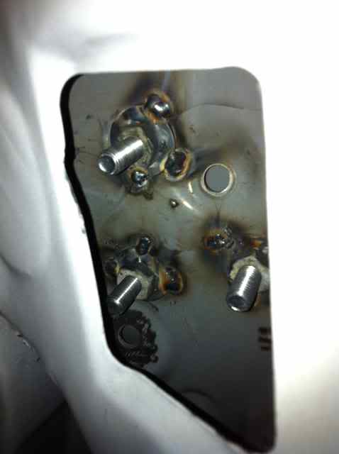

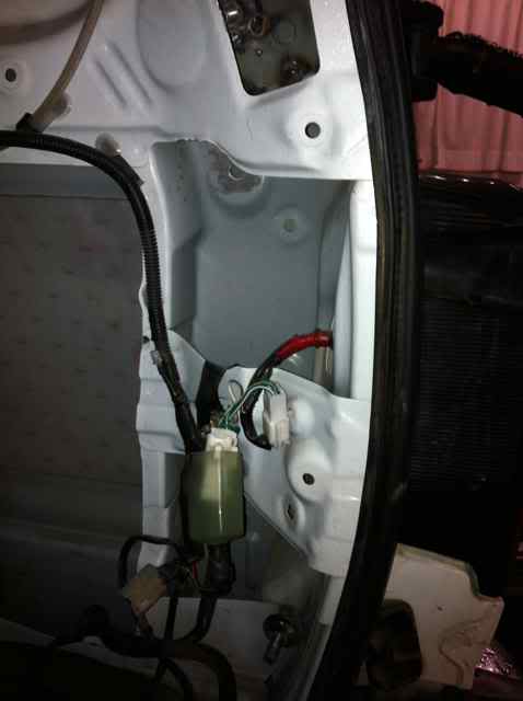

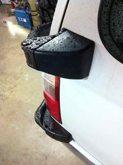

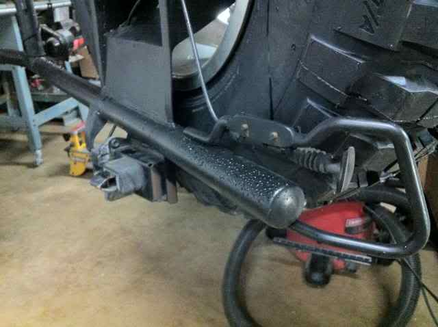

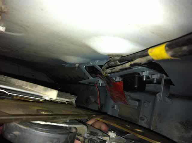

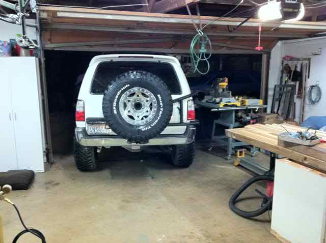

I purchased a Hilux Surf Tire Carrier from Ebay.co.uk, it came off a junkyard vehicle and included the license plate light, rear latch, pressure switch, complete tire carrier and the plastic tailgate valence that replaces our license plate valence. I haven't read of anyone doing this retrofit so I thought I'd share what I have learned. The body panel on the Surf is recessed underneath the taillight to fit the bottom hinge of the carrier. The bottom hinge goes into this recessed area about 1/4" so instead of recessing the sheet metal I added metal to the hinge so that it is flush with the body. The factory mount has the tire offset on the passenger side, I raised and extended the factory tire mount so that my spare was centered in the back of the vehicle. Toyota added a little bit of reinforcing of the D-Pillar for the Surfs, I was surprised how little reinforcing was added by the factory. I went above what Toyota did and tied the whole D-Pillar together where the hinge mounts. This supports the added weight of the 35" tire and the extra leverage of centering it very well. The latching mechanism on the carrier is a double latch like the vehicle doors. I still have some work and I may change a few things but until then enjoy the pics!

I took a piece of 1/4" steel rod and welded rod around the lower mount instead of recessing the sheet metal. Otherwise there would of been a 1/4" gap between the body and the lower mount.

Inside the d-pillar at the upper mount.

This is inside the tailgate where the latch bolts to. I still need to enclose this with sheet metal. You can see the black box to the left of the two shiny bolts is where the rubber isolator goes in.
