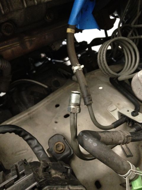

Sorry to bring back an older thread but I figured I could add to the issues ran into while replacing VC gaskets.
Please help...
1) Twisted fuel inlet hard line... Slipped and turned the coupler. Should I replace this and if so, what needs to be done to replace this? Is there a trouble code for fuel restriction? Picture attached.

Thank you both. Yes, I used a the FIPG... I was a bit liberal with it but in the correct areas.
Log - I twisted the line removing the fuel inlet hose to get better access to the drivers side cover. Cereal boxes? How so?
Have you found the part for the fuel pipe? Try the junkyard if you cant find a new one.
