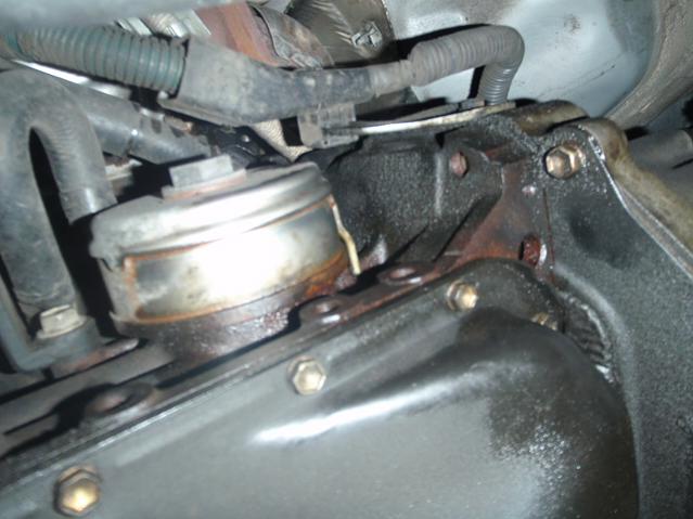

The Culprits
all leaks are coming from the head of the rotating part..
I think i need to buy the gaskets for those too?

so it looks like i need to replace the oil seals in the rear. do i need any special tool for this?

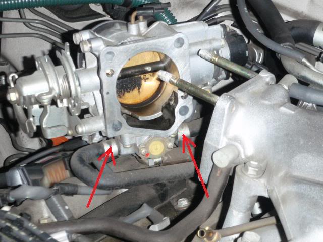

So I'm in the process of replacing my valve cover gaskets but there is a roadblock.
I can't get the 2 coolant hoses off the throttle body. I've already removed the clamps
but i really cant get it off,and I've read somewhere here to undo the (4) screws but can't get them to turn and I'm afraid i might strip it.
I know a lot of guys have dealt with this.. Can you give me some advise on how to remove these suckers.

Sometimes it is easy to just twist the hose to break it loose off the nipple and then it should pull right off. Make sure you remove the clamp far enough down because in this pic they are still on tight. If you use a pair of pliars or something you may put a hole in the hose.

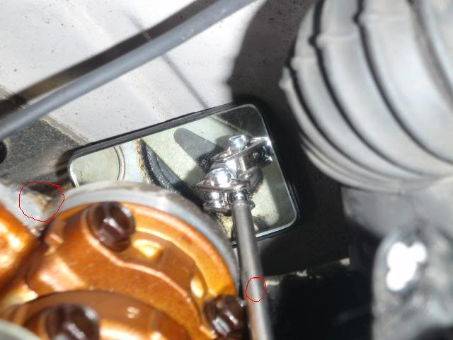

Here is the pic of where my leak is coming from
oil leaks out below that circular rubber cap.
how do i remove that circular rubber thing?

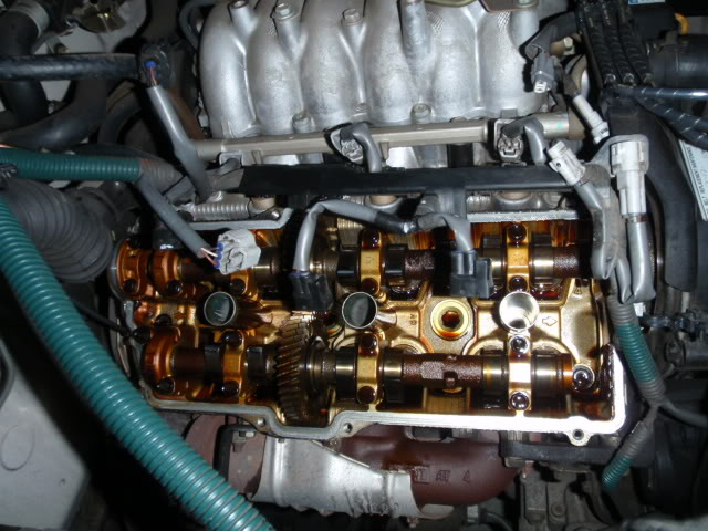

and a picture of my 110k engine

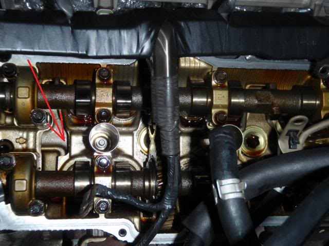

You don't remove the circular cap. That stays there. There should be some silacone left over in the right angle where the cam goes over the head. You need to remove the silacone only. After you get it clean, you will put some FIPG or HondaBond where the right angle is. You will also put some where the upside down semi-circular caps go where the other cam (toward the outside of the engine) is. You will need to scrape off all the old silacone. I did it with my fingernail, you can carefully use a razor blade but don't use a screwdriver or you can scratch the head. Don't remove the semi-circular caps. So that is 4 total places where you need to put silacone on each END of each head.
They usually leak there because of the right angle. It won't be a problem with a little bit of silacone to seal the gap.
Once you put on the silacone, you only have about 2 minutes to get the cover back on and bolted down at least somewhat. I used an inch-pound wrench to 53 in-lbs. I alternated tightening bolts to get the cover to go down as flat as possible. 53 in-lbs is the FSM torque spec. Let me see if I can circle where you need to put the FIPG.
Here you go:
See the RED circles?
Here is the right angle I am talking about (red circles indicate where you should put the FIPG):
Right side circle is UNDER the silver bar.
BTW, what is that silver bar? I don't recognize it.

gotcha stir fry! it makes sense now, the leak is coming from that right angle and goes down to the rubber circular cap. at first glance you would think that the oil is coming below the housing cap. btw, the silver bar on the left is a ground wire, it grounds the engine into the body of the t4r. If you're asking about the bar on the right, its the arm of my mirror tool.
Thank you very much!

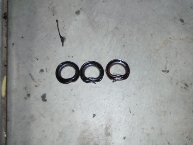

He removed the spark plug seals using a (-) screw driver and a rubber mallet:
angle the screw driver towards the hole and give it some love taps with a rubber mallet.

your old seals should look like this after removal:
