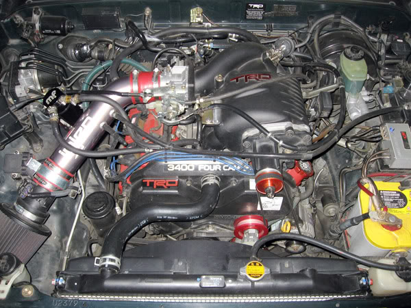

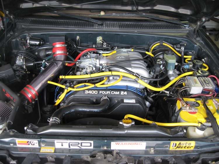

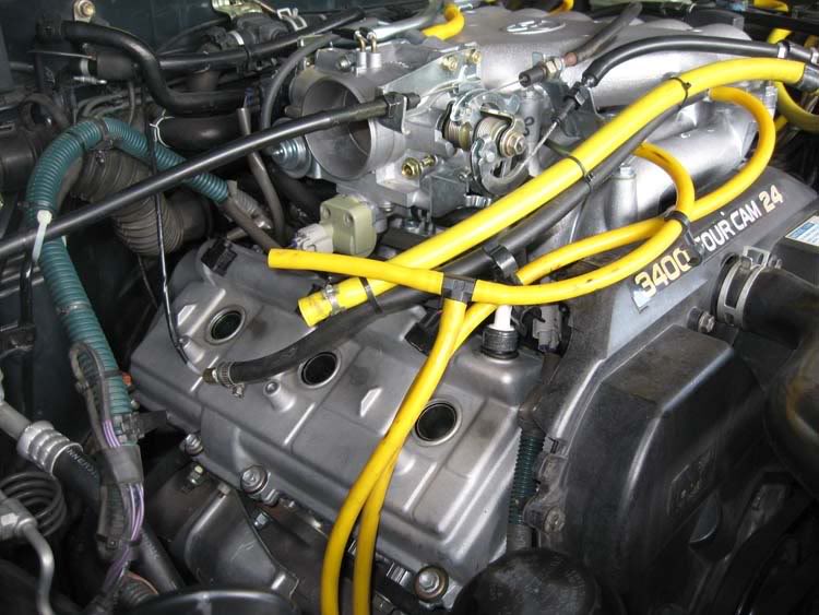

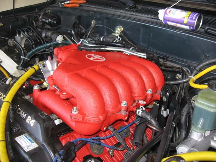

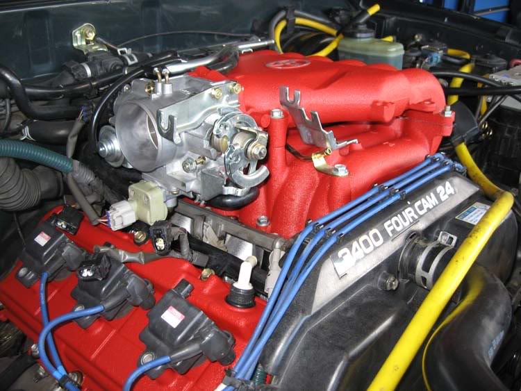

Finally got some time this past weekend to tackle this overdue project. Fixed the leaky valve covers and vacuum hoses with some additional touches thanks to callmej75.
Before
After

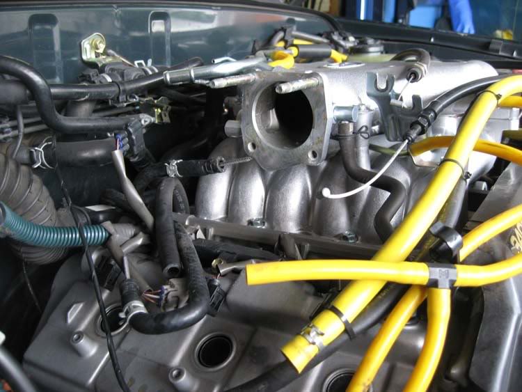

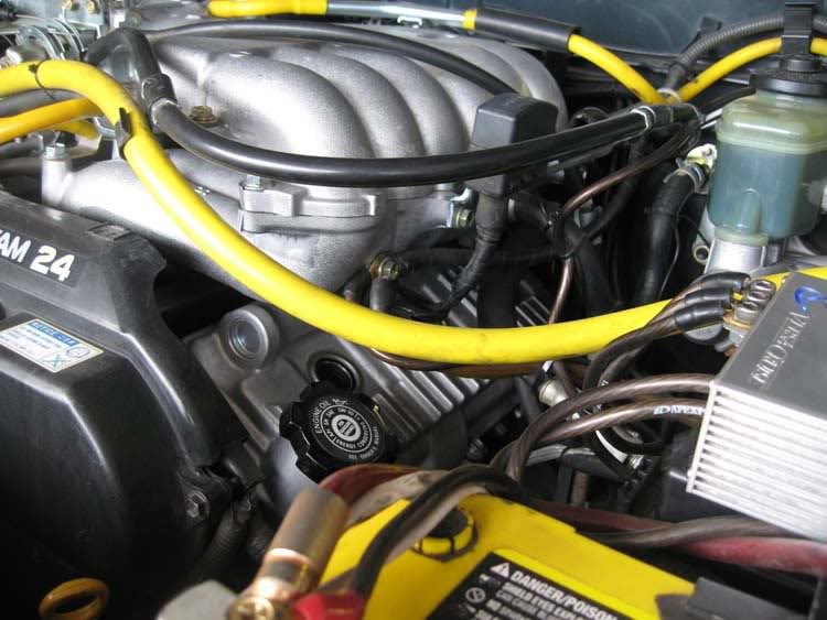

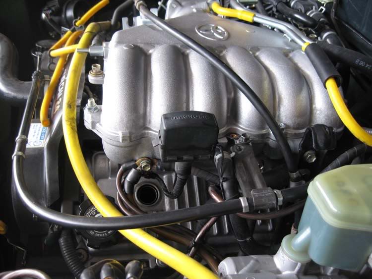

Brief step by step :
Remove the air intake

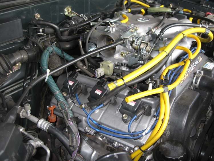

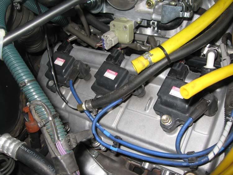

Unbolt the 3 10mm bolts holding the spark distributors and remove the spark plug wires

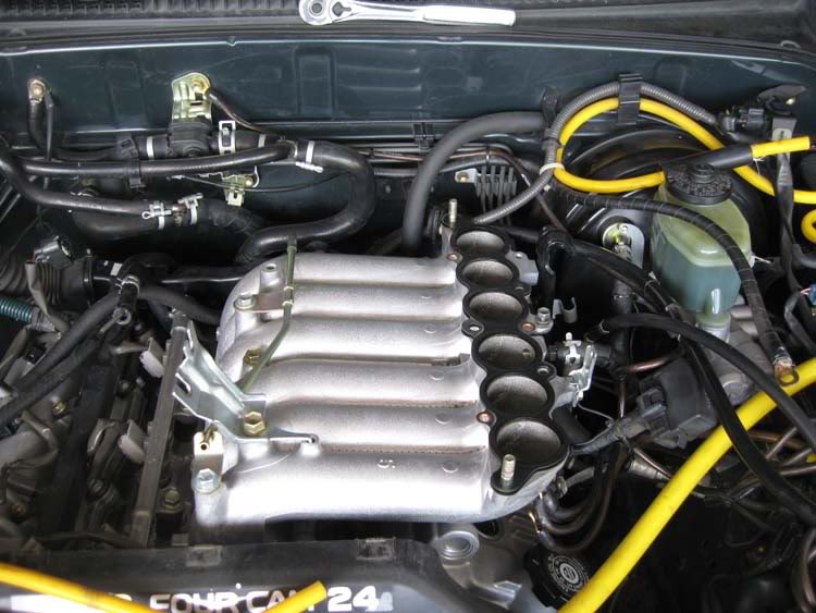

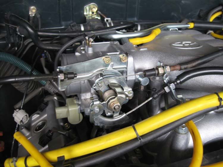

Remove the cruise control cable, throttle body cable, and the transmission kick-down cable

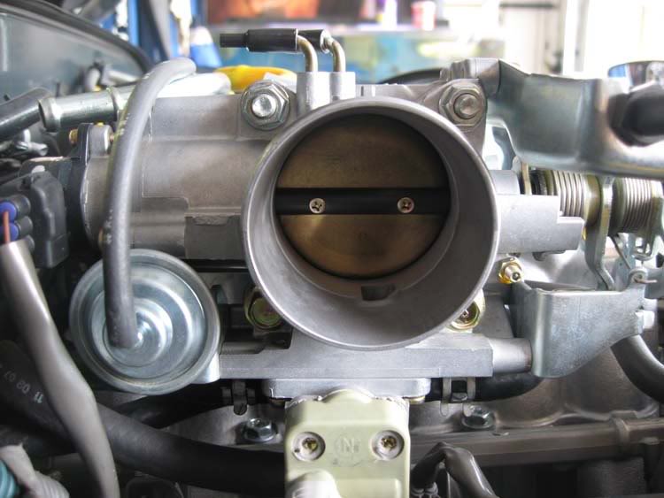

Unbolt the 2 12mm bolts and 2 12mm nuts holding the throttle body. You will also need to unplug 3 hoses that under the throttle body and plug two of them as they will star leaking coolant....I just used some standard drywall screws
Throttle body removed

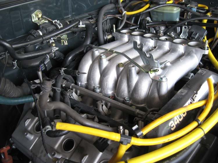

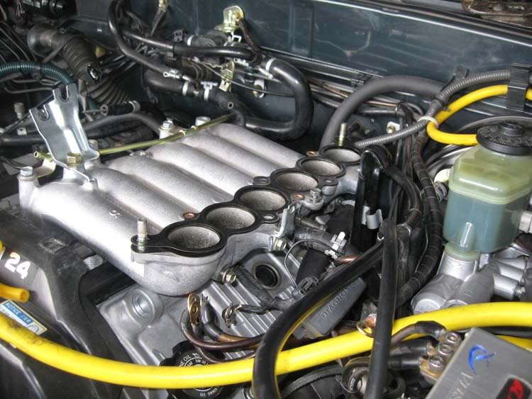

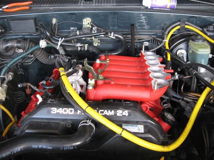

Remove the 12mm bolts and nuts to the upper intake plenum
More 12mm nuts and bolts on the lower plenum

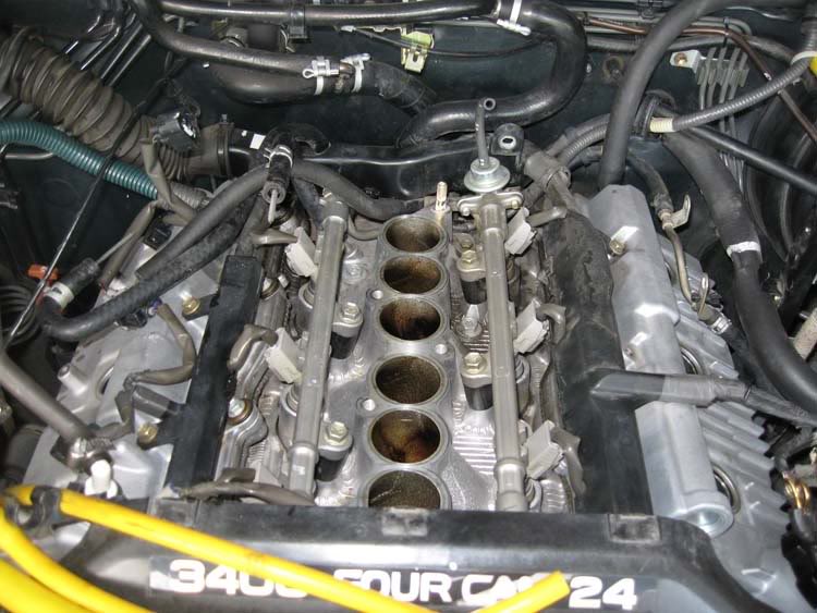

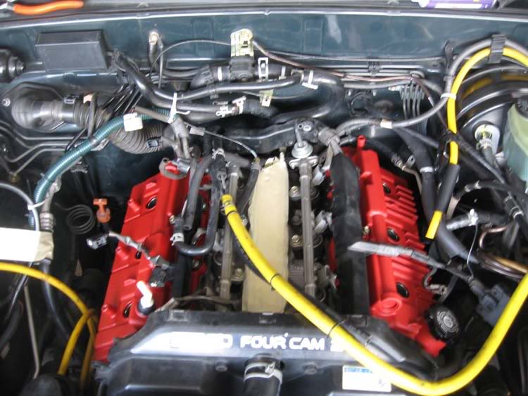

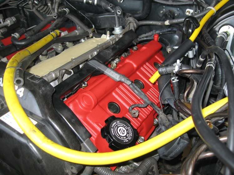

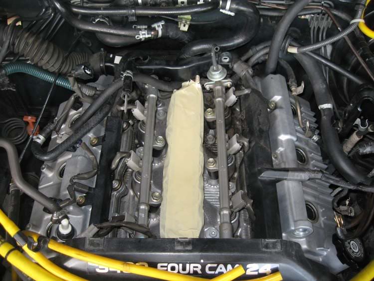

Once you have the lower plenum off, you will need to tape the manifold to prevent dirt and tools from falling in.
Nicely taped off.

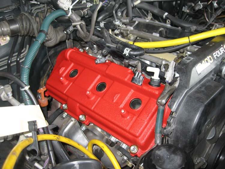

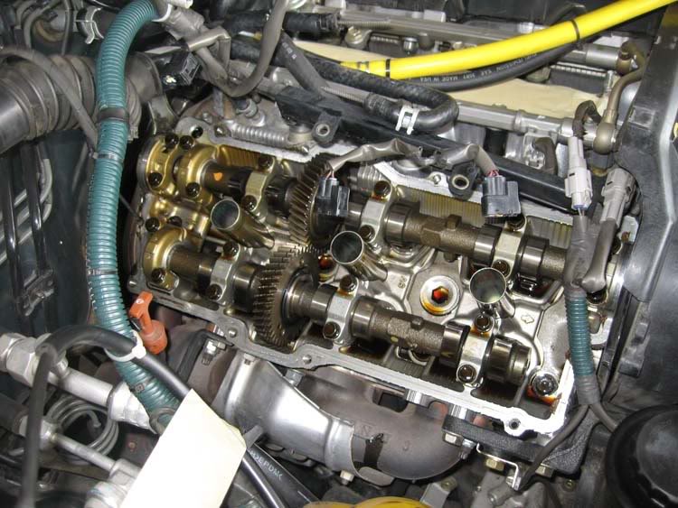

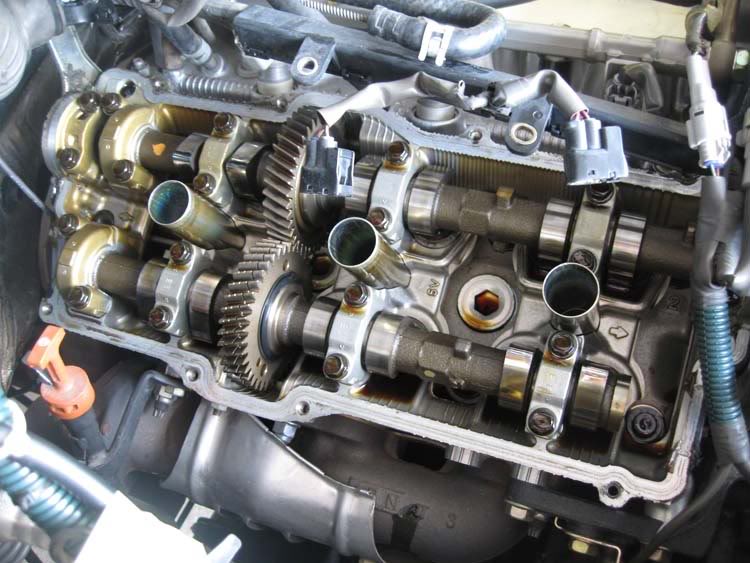

Unbolted the 8 10mm bolts and removed the passenger side valve covers....Pretty darn clean considering it as 135,000 miles on it
Replace the gaskets, apply some silicone on the halfmoons and bolt it back up

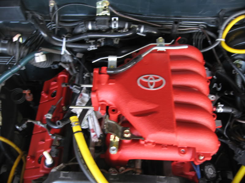

Bolt back the lower intake plenum...don't forget to remove the tape.

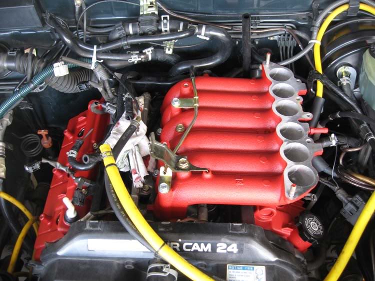

Plug back some of the vacuum hoses and attachments
Bolt back the upper intake plenum
More vacuum hoses, diagnostic box, ground cables

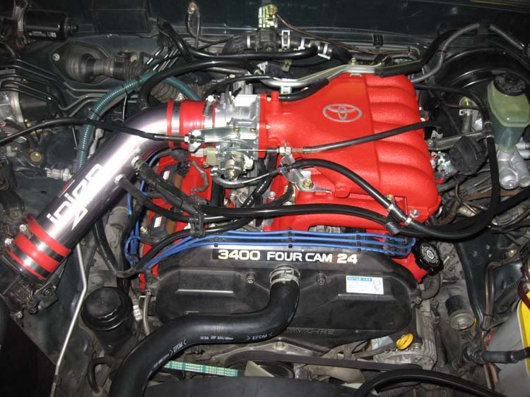

Spark plug wires and distributors plugged back in.

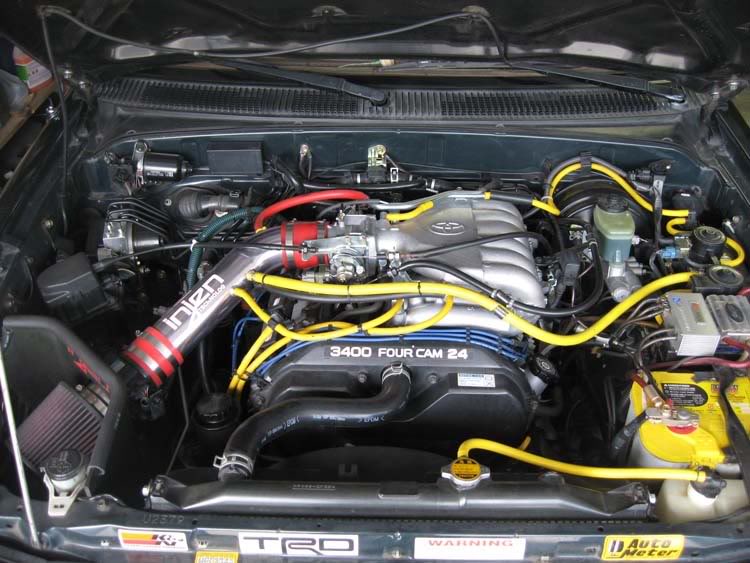

Its good to know that it helped you guys out . As for the oil, all I use on all my cars is Mobil 1. Oil change intervals are roughly around 5k.
Heres where it sits now:
