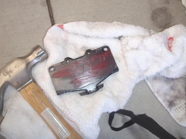

Second Update: Replaced front brake pads
First of, I want to thank you guys for the good tips, especially stir fry and 98runner210. Very much appreciated..
I noticed that the leaking stopped after I tightened the bolts on the valve cover gasket, they are still on probation though.
Replaced my front brake pads today and bled the system. (see pics of my old fluid below).
Couple of questions:
1. Where is the load proportioning valve on my rig(97, 3.4, 2wd)? A pic would be helpful too.
2. It looked like the hawk pads had shims attached to it already, am i right? I tried to attach the old shims but they didn't fit. There is also a little piece of metal attached to the brake pad that I broke off, i didn't bother to put it back on. I'm guessing thats the metal that rubs to the rotor when there is no pad left to tell you that you need to replace your pads.
Total cost replacing brake pads and bleeding the system:
Hawk Brake pads = $63.00
Improvised Brake Bleeder = $20.00
Brake Fluid = $5.00
Total = $88.00
Total money saved = $250.00 - $88.00 = $162.00
Attached Thumbnails Replacing valve cover gasket-brake-pad.jpg   Replacing valve cover gasket-old-brake-fluid.jpg   Replacing valve cover gasket-brake-bleeder.jpg
