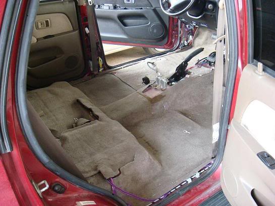

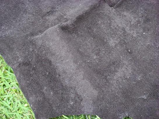

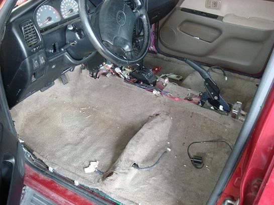

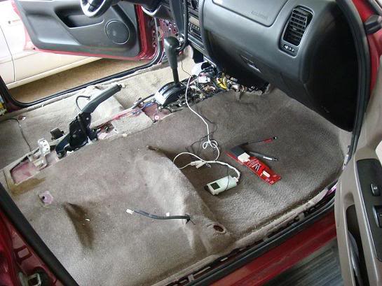

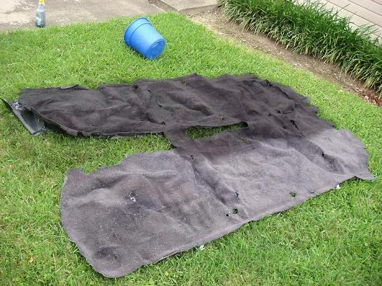

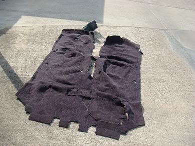

Finals are over finally. Today I gutted out the seats to pull the front carpet. I ran it at the washateria with the RIT t shirt dye from walmart. But you can't control the cycle so after the first wash it was only dark gray. Plus all the lint from the padding went everywhere. So I took it home and mixed the dye powder into a spray bottle with hot water and started spraying. Its looking okay right now but I need to let it dry first and rinse it somewhere before I put it back in. I'm gonna post pictures in the next post I make.

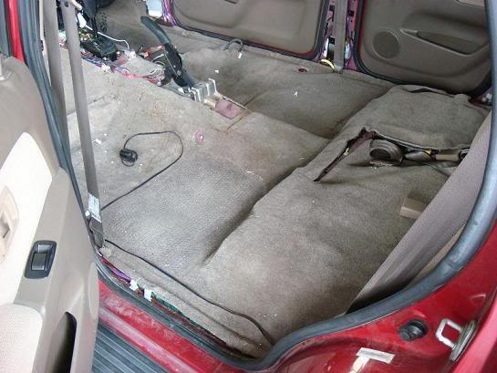

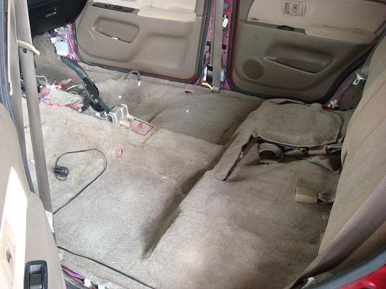

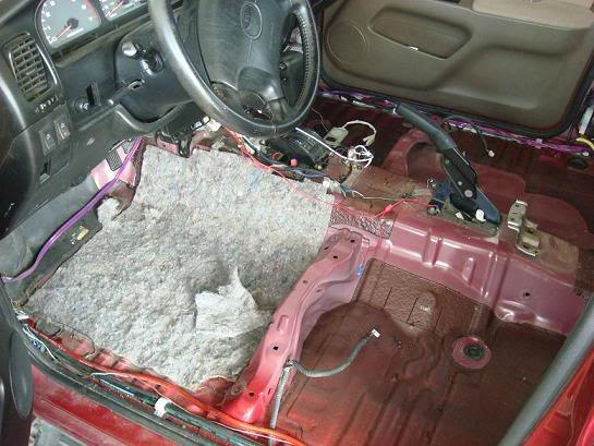

Gutted

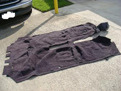

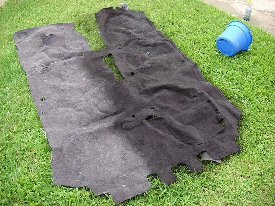

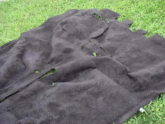

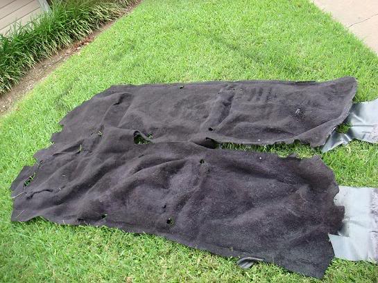

Dying it black...

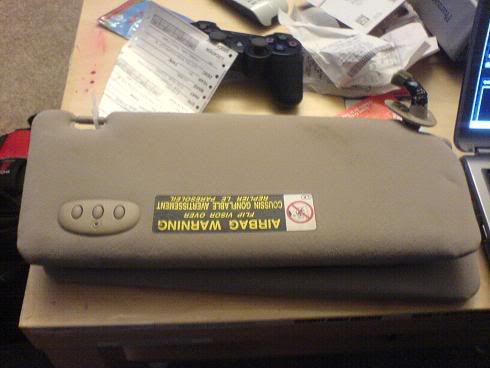

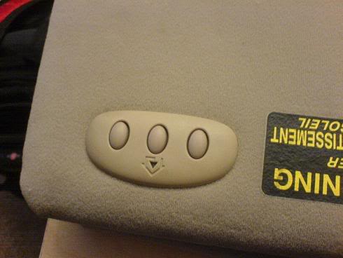

I got a set of is300 sunvisors that have the homelink module. I plan on removing it and then installing it in the headliner and power it using the upper light console as the source.

Update for today...I went to a different washateria and ran another cycle to even everything out. It's not as black as it could be if i would have tub dyed it but I dont' have the time to have my car with just one seat in it so I let it dry and I already reinstalled everything. I'll post pictures later tonight.

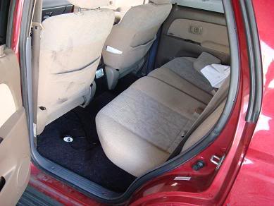

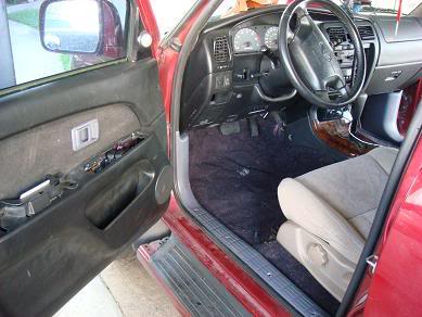

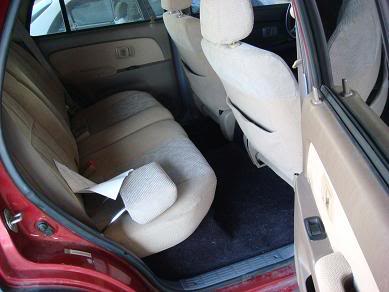

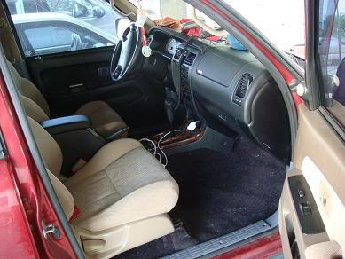

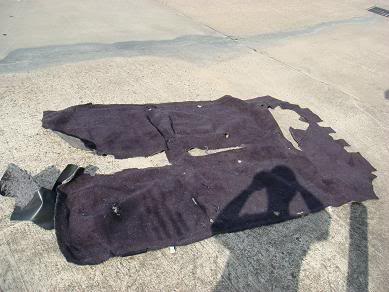

Carpet...Done I think...
Carpet is done...I just need to get a lint roller to roll it all back up. Downside? I might have to get brand new carpet if it doesnt clean up well...theres alot of lint from the padding and such. Also not dark black...I just need a functional car right now though...so I can't do without the seats right now.

Heres the carpet installed...there are some wrinkles that need to be ironed out...the problem with stuffing it in the washer...I'm sure.

Word of advice for anyone attempting the carpet dying. Get a large tub...use lots of hot water and LOTS OF RIT DYE...like triple the amount. I read the directions on line...all you have to use is the tub and a large stirring stick for 10-30 minutes. Unfortunately you also have to rinse it afterwards...but it'll still be better than washing machine style...especially for something this big. You'll get more even results and and the carpet won't be thrashed by the washing machine. I'm learning alot from doing this but it'll be good advice for anyone attempting this in the future.

Here are pictures of the IS300 visor thats donating my homelink transmitter for my car...
