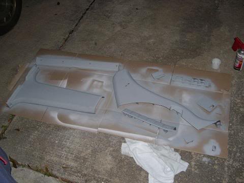

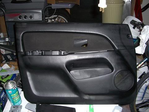

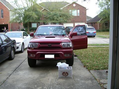

Okay so I know its been a few weeks but I finally got some free time to start on a few parts. Here we are at the new painting location...my friends house.
Heres a couple of pictures of the parts getting ready to be painted. The dash will finally be complete after this.
These are all from the driver side of the car.

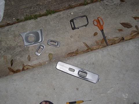

These were sanded so that they can be painted to the gunmetal color instead of the tacky silver I had back in highschool.
Heres a glimpse of something we finished today.
We ran out of interior paint today so we could only finish a few pieces. So I removed as many pieces so they could be primered and then my friend and I will start up again on Wednesday and then I can try to do some more Thursday after I get my other interior parts in.
