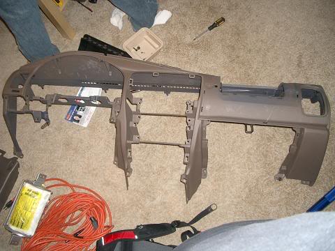

Does the whole dash board have to come out in order to remove this dash pad? It looks like it simply clips in place.
Yeah bc it requires some metal clips to be unbent to remove the pad and then bent back into place afterwards.
