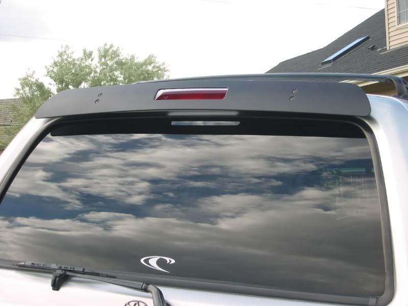

I forgot to post the results, I did it a couple weeks ago, they came out well... I did the rear spoiler too while I was at it. Thanks again for the help GREEN4SKIN'R!
The mark on the rubber strip of the cross bar is from the needle nose pliers I had to use slide the piece back in place, that thing was tough to get back in!!!
