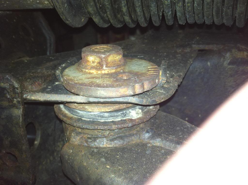

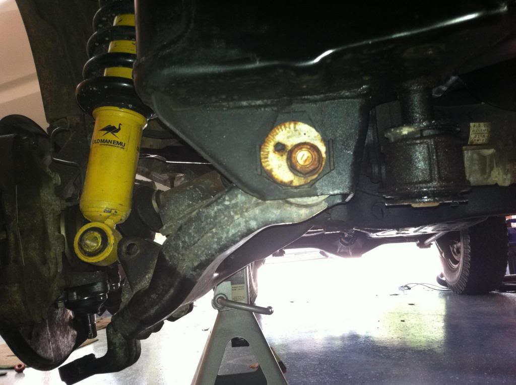

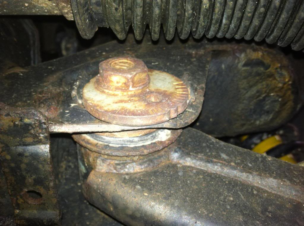

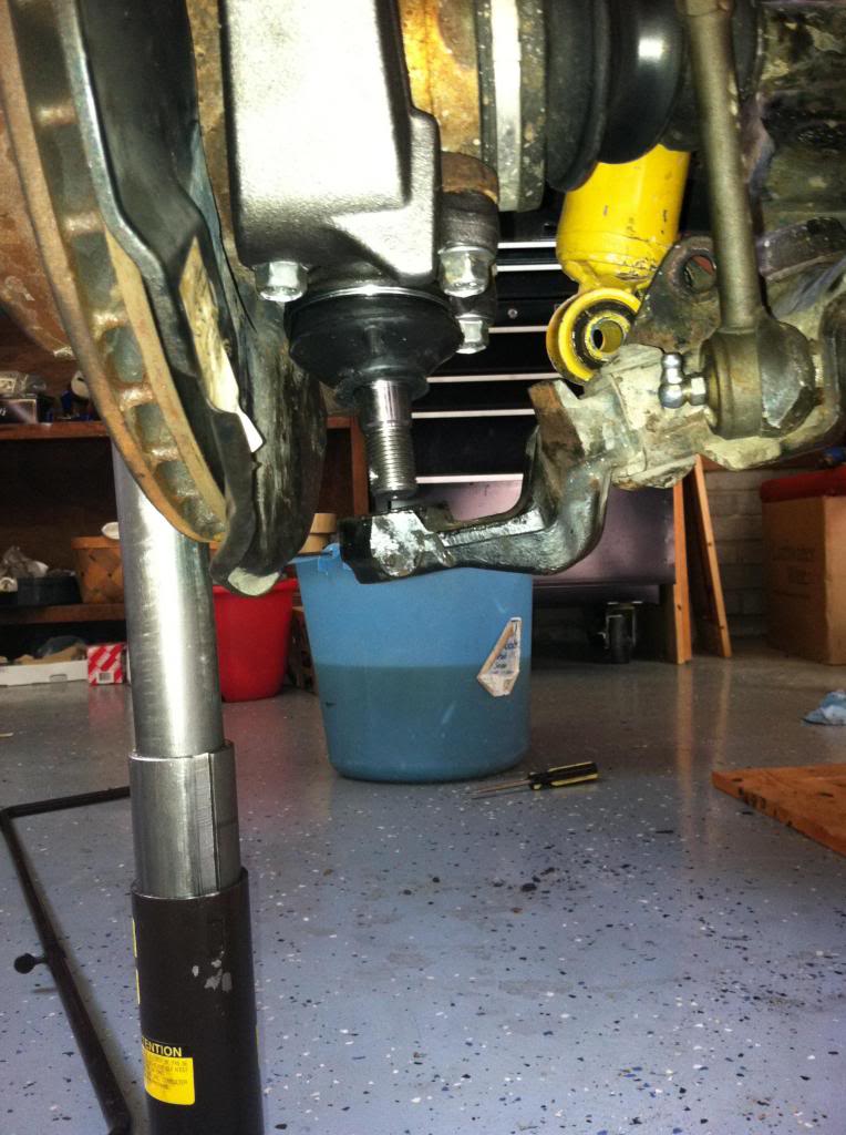

Furthermore, I have the whole front end disassembled and noticed that the passenger side control arm (the problem side) "droops" much further than the drivers. I also noticed that the Cams (I think thats what they are called) are positioned incorrectly. See pictures below comparing the two...
Passenger Side:

Driver's Side:

Note the discrepancy between the positions of the two cams.
Also notice how its pressing up on the bottom of the shock on the driver's side but just hanging on the passenger side.

Do the cams adjust this and if so how or is this a bushing issue? Could I adjust it to match the driver's side or should I just tell the shop whats going on? Are these cams what adjusts the camber?

It feels like the good side (driver's side) is simply "set" higher and offers a good bit of resistance when pushed down. Does this amount of difference between the two (at least a few inches) equate to .6* of difference on the machine?

Your adjuster bolts may very well be seized and the shop simply does not want to deal with the hassle. Two of mine were a few years ago when I replaced lower control arms, lower ball joints, and upper ball joints. I ended up replacing all of these bolts as well and using a generous amount of anti-seize on all surfaces.
