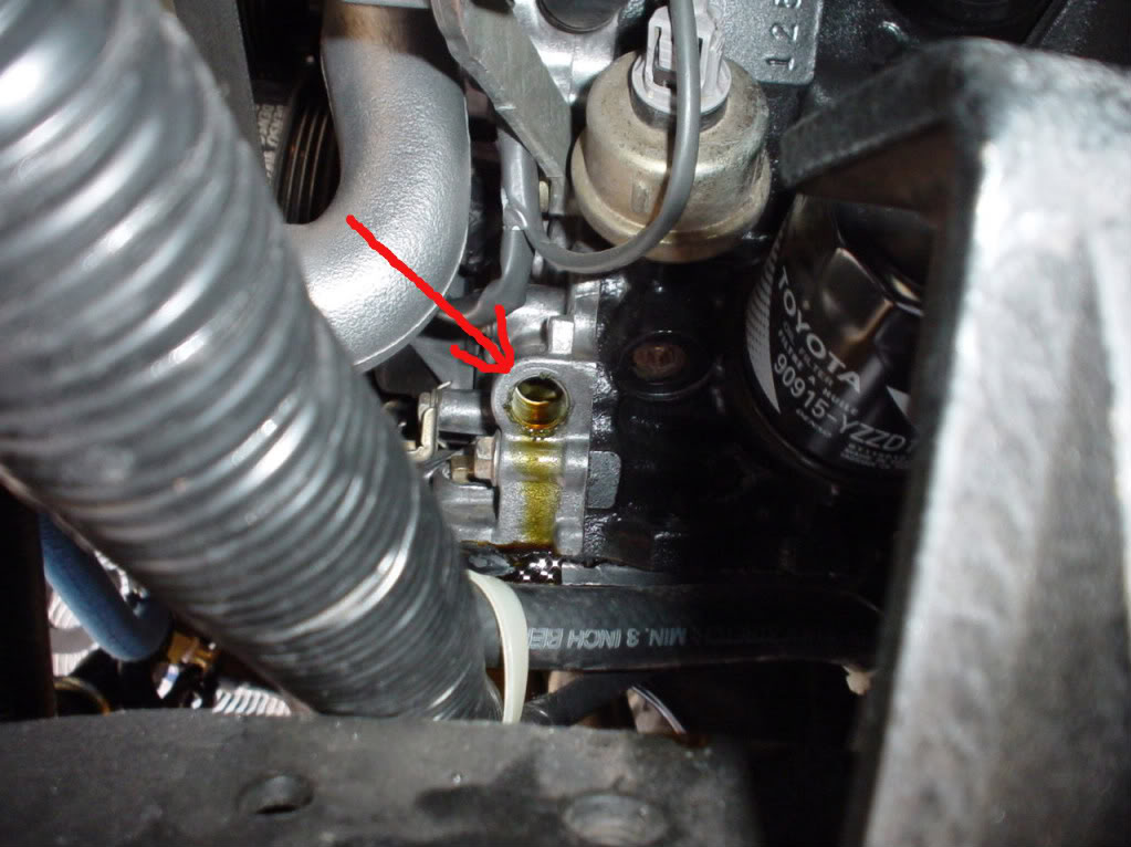

Originally Posted by j-man
There is a tapped plug near the oil filter that can be used. So i just ran a SS braided line from there to the top of the turbo...
This one?

That is kind of scary, because that adds another bypass for the oil pump. All the flow through the turbo oiling system has completely bypassed the engine's lubrication system, oil cooler and oil filter. I wouldn't have wanted to be the first one to try this LOL.
I'd definitely check the oil temps with that setup, my oil temps got up to 260* F running 10 psi of boost before I added an extra oil cooler. Oil temp taken at that hole in the pic above (oil pump discharge port). That location could be as much as 50* cooler than the hotter parts of the engine so figure 310* F possibly.
I'd also run a little test measuring the oil flow through the turbo. Let me know if you'd like details on how to do that. It would be important to know because that flow is what is stolen from your engine's oil pressure and flow.

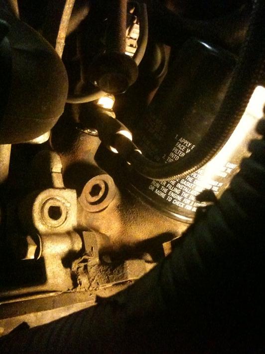

Actually no, i put a T fitting where that sensor is off the block. You took it off the aluminum port - not sure what that's for. On my buddy's turbo tacoma 3.4 - he took his from where i did (see pic) and has a oil pressure gauge hooked up to it and has been full pressure all the time.
... You took it off the aluminum port - not sure what that's for.....
I've been told its called the "oil pump discharge port", but any of those 3 ports in that area are probably right off the oil pump (start of lubrication cycle with oil fresh out of the oil pan).

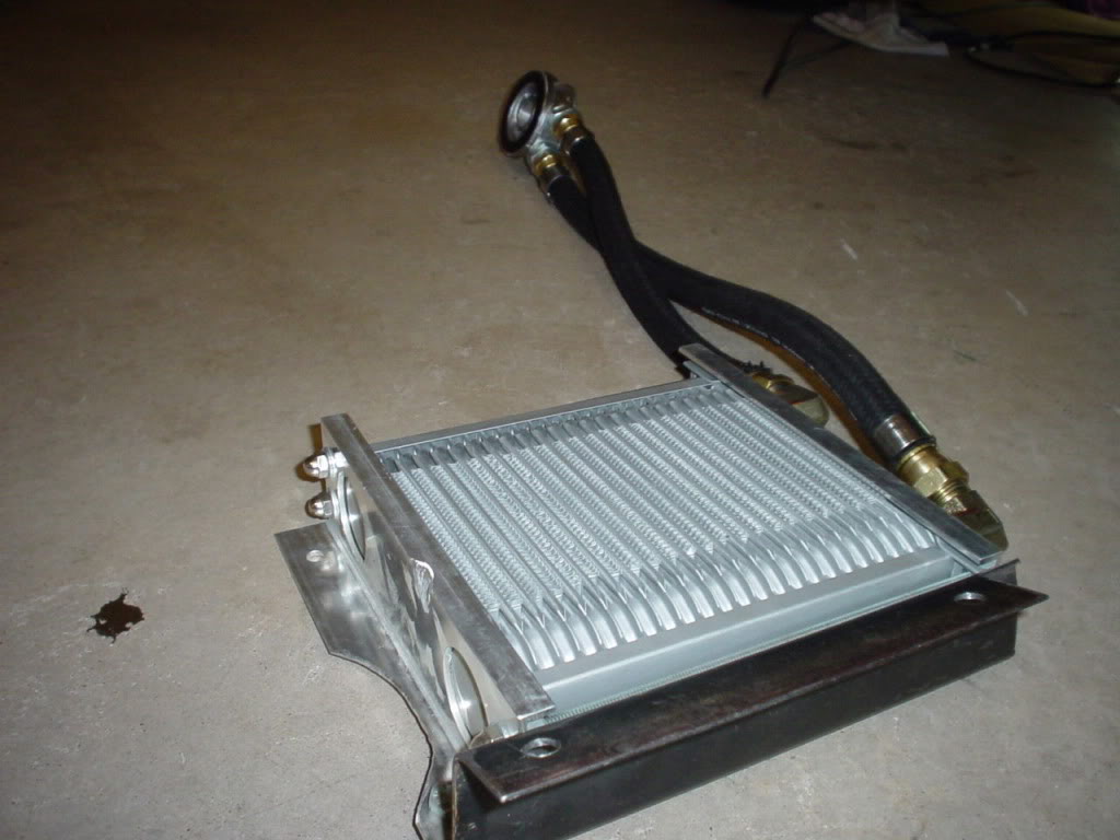

If you monitor oil temps I see one of these in your future:
