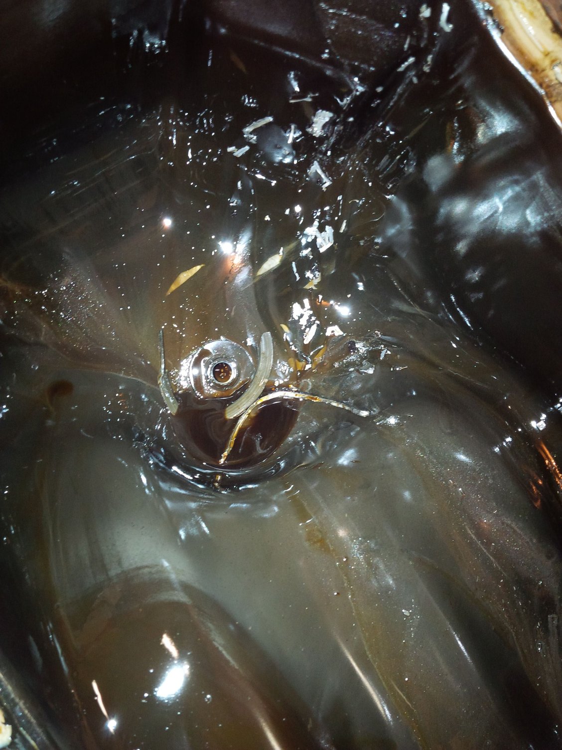

This was left in the pan when I removed it from the old engine!

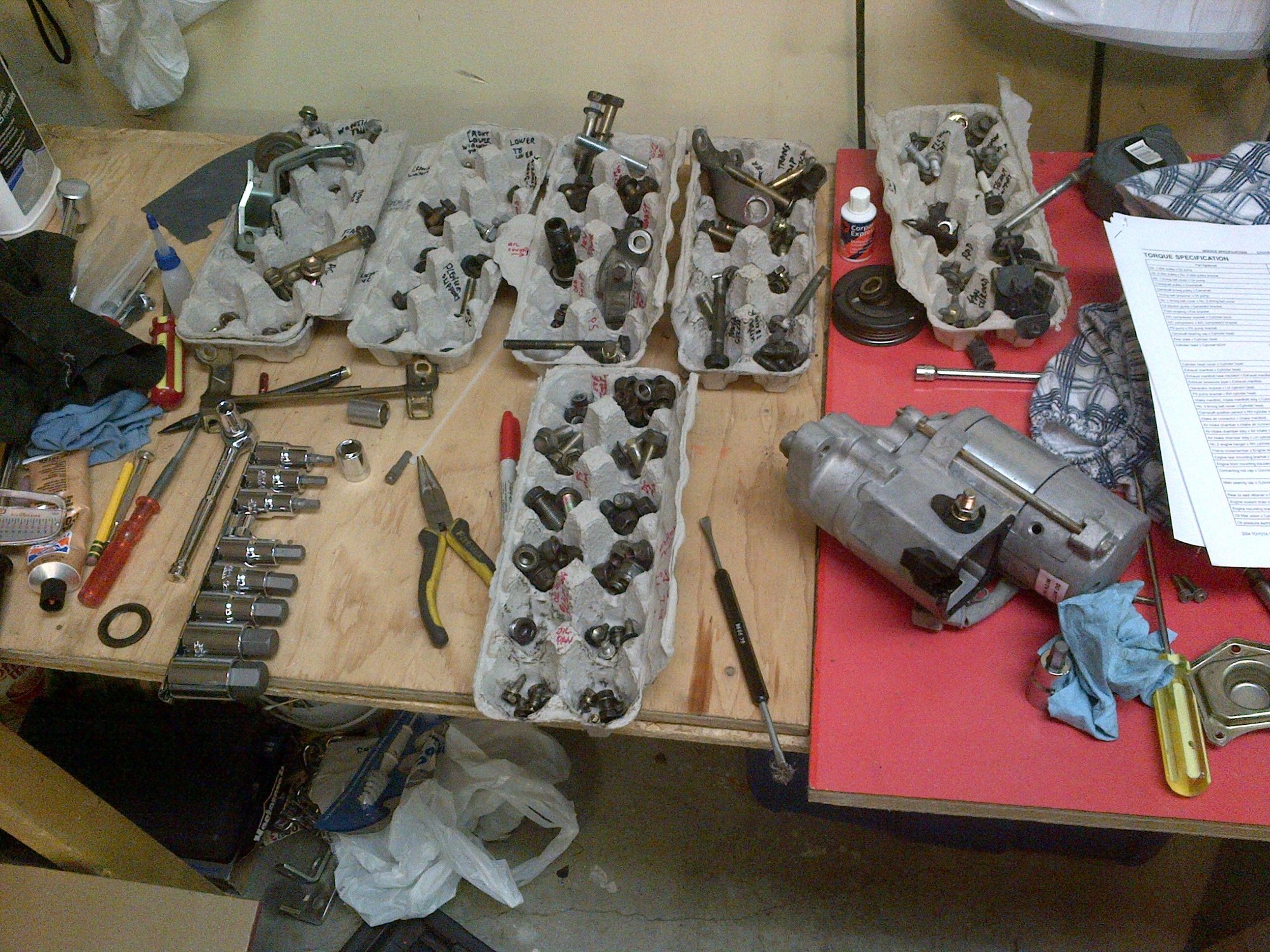

Here's how I kept the bolts and parts straight! Took lots of pics and labelled everything! Made life way easier when I put everything back together a month later.

Awesome thread - thank you. I'd say your oil pan pic was pretty telling...

I suspect the previous owner never changed the oil! My truck only had 227K km = 141K mi. While researching my "noise" I came across a few 5VZ-FE's with rod knock(my problem), but considering the total number of these engines that are around, I imagine it's not common--- but probably quite rare. I couldn't find that many lower end failures. However, when this engine eventually fails, it appears to be the top end, usually a head gasket. There are a fair number of threads dedicated to this. Top end failures are definitely more common.
As far as my engine was concerned, it still ran(even with all that metal in the pan), I noticed virtually no loss of power (but more noise!) but I imagine it would have eventually catastrophically failed!
