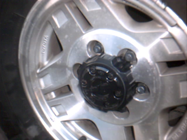

The stock rims just look a little funky without the stock, plastic hub covers. But you can do what Victor did...he used a Dremel to hollow the top out so the stock hub covers would work on his manual hubs.
Me? I got a pair of factory metal hub covers made for the manual hubs on Ebay for $6.
You got pics? not sure what you mean by hollowing out the center....
Hollowing out the center means cutting the center with a 3 1/2 inch hole saw to get the center piece out, then file the edges to smooth it out. Here's another picture taken by yours truly.
www.yotatech.com/attachment.php?postid=54490

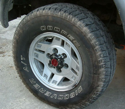

I have stock wheels and i think my hubs look fine!
Just my 2 dracma
