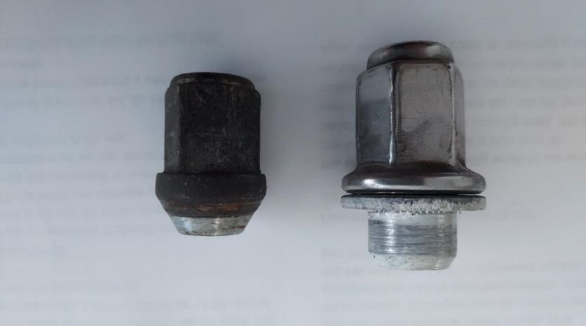

My OEM nuts are both tapered and "washered", so they can work for both. That's why the washers are jangling. The nuts are on tight, but the washers float free. The photo SomedayJ posted with the washer looks like an aftermarket nut. Admittedly I do have a couple of those...I've started breaking lugs and the OEM nut is stuck on the broken lug so I've been replacing with the style shown in the photo. Which was fine until I switched to steel wheels earlier this year. I have three of those type. All the same, I want to replace mine so I don't hear the jingling as I drive in town with my windows down.
Being lazy and not wanting to take off a nut...the stock steel spare wheels ought to be acorn/conical/taper, not ball/radius seat, correct? So these would work?

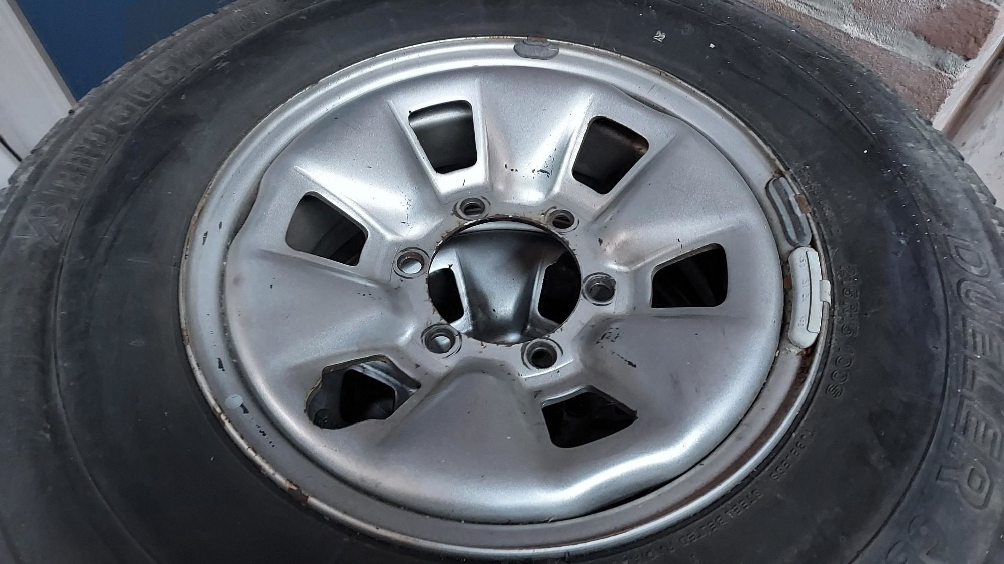

My 2 88 4Rs came with these steel wheels:
and lug nuts like the one in the left (the pic of my previous post)
I got the alloy rims later:
https://www.yotatech.com/forums/f116...l#post52468120
and I bought the lug nuts with washers (like the one in the left) from a Toyota dealership, they are OEM.

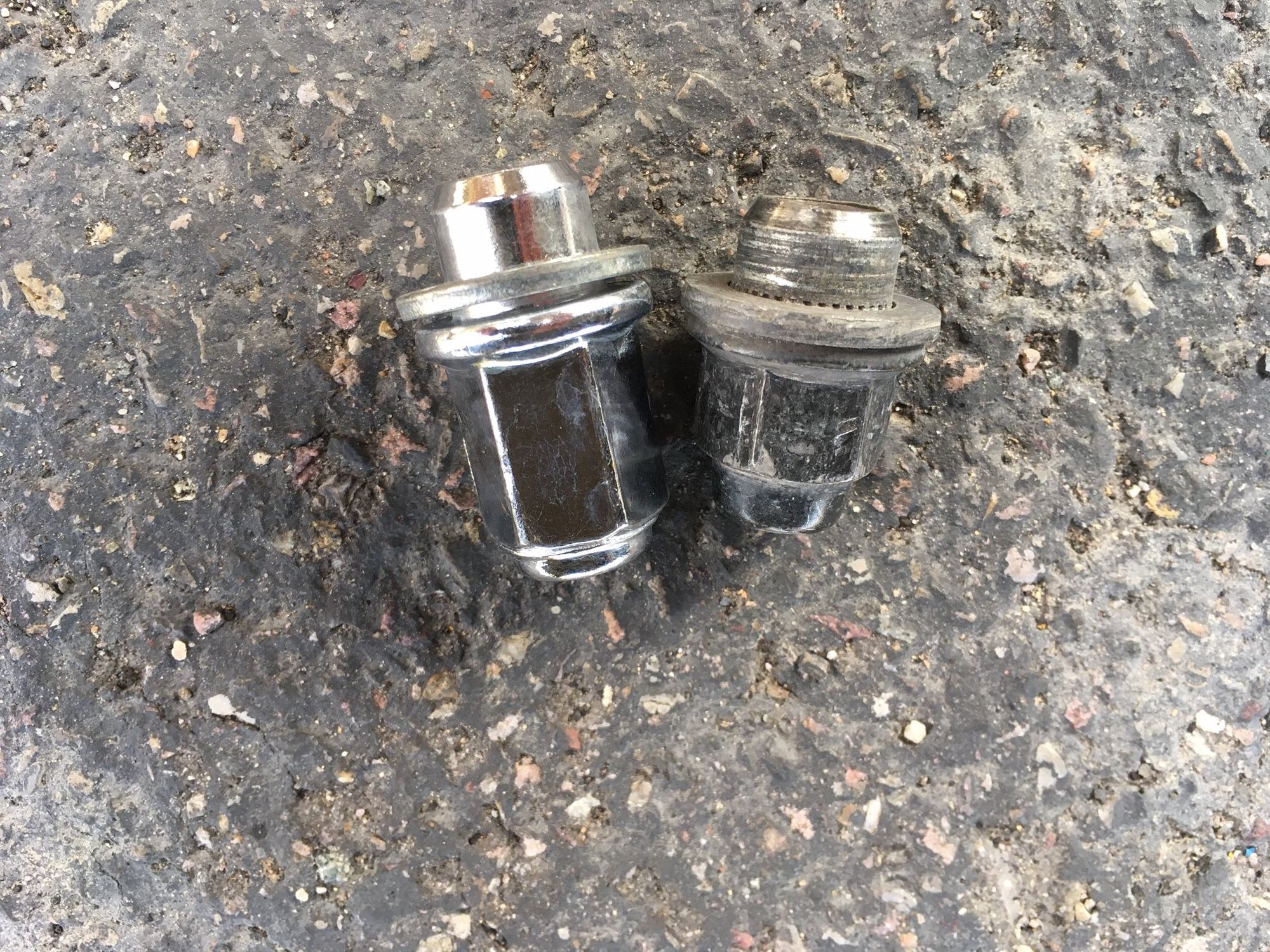

I got over my laziness. OEM nut on the right, aftermarket (Oreilly) on the left. And my wheel kinda looks more ball than conical...I'd really need examples side by side to tell.
