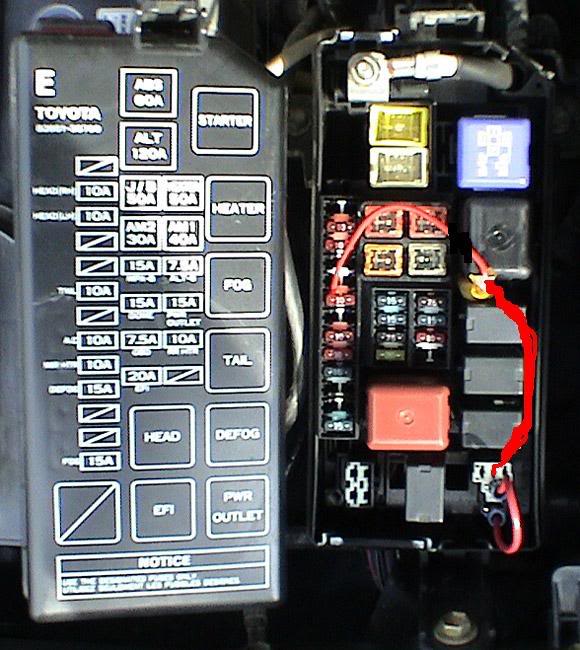

this how my fog lights where wired..
i stole the pic from this thread wich i followed but changed where i got my power from..
https://www.yotatech.com/forums/f127/factory-fog-lamp-re-wire-mod-3rd-gen-4runner-75177/
before i connected the wire i tested the plug. It is a 12v acc basically.. so my fogs have power as soon as the key is turned. i like to think that i am mechanically/electrically inclined but sometimes i wonder.. by the way the dealership said that even though they dont recomend mods the specific ones i did did not cause/were not involed with the wire burning..

So the fogs were relayed...
BTW - its techically a "non legal" way to wire fogs - by law they are supposed to turn OFF with the high beams and ON with the lows...
One could wire a swithc to select between a low beam only (legal way) or accessory (more useful way)... not that I have anything like that in my truck - no sir
so still wondering how your mess occured...

https://www.yotatech.com/forums/showthread.php?t=75177
I just tried to move my fog wire over to that spot, but it is closed. Can I use the hole on either side? I want mine to be able to go on without the parking lights.
