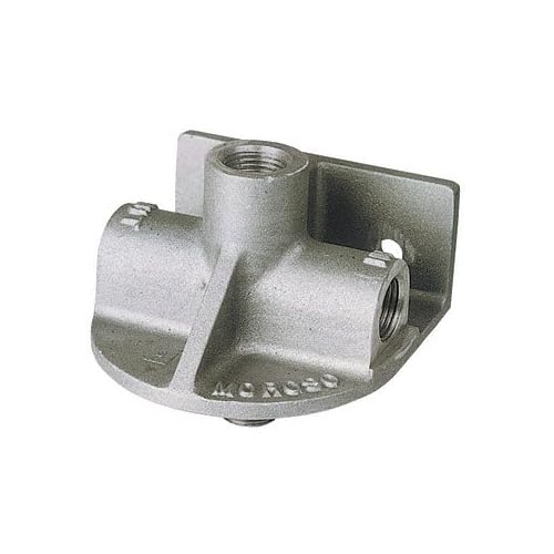

Old Jan 5, 2010 | 10:44 AM
The Ruckus's Avatar
Posts: 212
From: La Grange, IL
Looks like this would work for the filter/sending unit application, yes?
The picture made me realize that it's essentially the same thing as making your own sending unit block out of brass fittings, only this way is pre-fabbed and adds a filter. The money that would have got to making the block can go towards the remote filter adapter, and in the end it's probably not all that much more expensive, with added benefit. Ding, the lightbulb just went off
Anyway, it's a Moroso 23760 for a Chevy V8, so finding filters for it should be easy. $33.69 on amazon (cheaper than Jegs and available to ship 14 days sooner), but I'll go check out my local spot since I'm sure there's something around here that'll do the job without additional shipping costs and wait time. I'd like to find something that runs a small-ish filter like a Honda Accord, so I'm not taking up space and exposing a giant v8 filter to potential debris and impact damage. Maybe I'll see what I can find in that vein.

Originally Posted by The Ruckus
Any idea why more people don't do it? is it cost-prohibitive? Hard to install? Space constraints? Does the screw-on filter restrict flow to any point that should be a concern?
Most people don't for several reasons. The first is it just doesn't occur to most people, they think it has a filter so is doesn't need another one. Its not really hard to install at all. If your putting in a transmission cooler in front of the radiator its even easy to install because the lines are already out there and you can just mount it up under the bumper below the headlight (that's where mine is).
Any filter that is effective is going to cause some pressure/flow drop. A normal screw on type oil filter is designed to cause a very minimal drop so as not to starve the engine of oil flow. When used for transmission fluid a standard oil filter can be changed at 30,000 mile transmission fluid change intervals and even at that they still have life left in them.
I have a aviation oil filter cutter which works like a really big pipe cutter and spins around the filter to cut it in half. I've cut open a oil filter after 30K miles in transmission fluid service and it virtually no contaminates in it and probally could have gone another 30K. But since oil filters are cheap why risk it. And with that kind of interval don't be cheap, use the mobile one $10 filters they are worth it!!!!

OH, so those models ARE tapped for a sensor! In the crap pics on summit/jegs/amazon, they don't show that or mention it really it all, so I was ignoring them. In their shots it looks like there's just inlet/outlet. Another option in the bag, thank you man.
EDIT: wait, is that you sending unit in the middle, or is that just a plug? Now that I look closer, I'm unsure.
Old Jan 5, 2010 | 08:27 PM
logsurfer's Avatar
Joined: Sep 2009
Posts: 129
From: Sunny San Diego
that is a plug.
