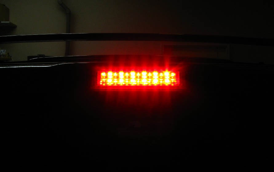

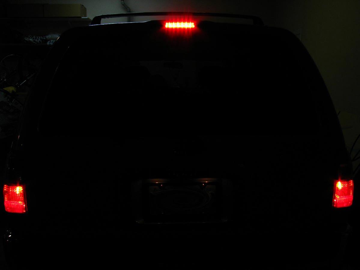

Hey guys! I made my own LED CHMSL a while ago but never got around to posting pics. I used the stock housing and designed a PCB for my setup. I personally like more densely packed LEDs than the one that is currently being offered for sale. The pictures are taken a bit darker than usual to show more detail. For brightness comparison, I am using the stock 2002 tail lights and during the day, my LED CHMSL is slightly brighter. I hope you all enjoy!

I like it! I made my own as well... and I also like it better. Did you sand down the lense at all to get rid of the pillows? I can't tell exactly from the picture... I did that and it looks a LOT better now. Here is a picture before I sanded down the lenses:
Thanks pdyebrasil! Yours looks awesome too! I didn't sand down the 'pillows', but I designed the PCB so that the LEDs perfectly coincide with the 'pillows'. I like the effect it has on my CHMSL. As you move side to side the LEDs almost flicker, but because of the spacing I chose, still look very uniform.
